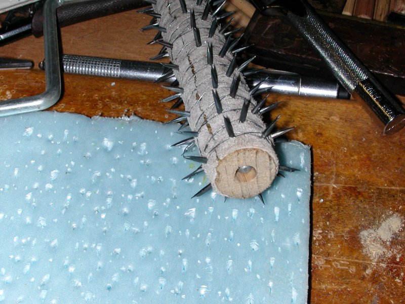

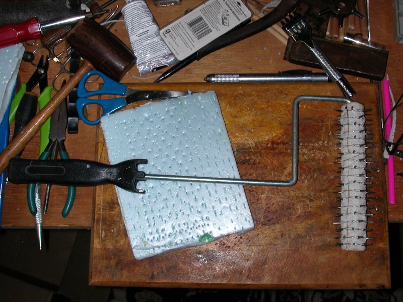

Been lurking for a while now but you Foamies have gotten me to thinking about building another camper. Looked at the perforating tool but being cheap decided to make my own. Drilled a 1/4" hole through a 6" long piece of broom handle. Turned it true on the outside on the lathe. Cut a piece of leather to fit around it and punched a couple of hundred holes in that. Put 7/8" carpet tacks in every other hole, coated the roller and back of the leather and tack heads with contact cement and once tacky put the covering on the roller. Put a short (cut off) nail in one end and using beading wire secured the end to it and then wrapped around each tack from end to end, then put in another nail at the other end and finished it off. Used a roller handle to try it out. I may make another one for it to support from both sides but it works ok as it is. Thinking about covering the leather with epoxy. Gonna test a couple of small pieces of foam out once I get some fresh GG. All of mine has gone bad. :( Couple of pictures below.
Note that the piece of foam has been run over SEVERAL times with it while testing it out. Will try to get another picture with just one pass on another scrap when I get home.
Thanks for all the great ideas folks!

Postby GPW » Thu Jun 16, 2011 2:57 pm
Dave , That's just too COOL !!! You guys are just remarkable in your resourcefulness ... Those perfs should really hold anything down really well !!! :thumbsup: 8) :applause:

Postby Ratkity » Thu Jun 16, 2011 3:22 pm
OMG!! That thing looks like a medieval torture device!!!
LOL, good job at thriftiness. How many holes did you put in your fingers with those tacks? I hate those prickly things.

Postby depatty » Thu Jun 16, 2011 7:16 pm
GPW, Thanks! I'm looking at using layers of foam so need to really hold it together and don't really want to have to remove the membrane or sand it all. Figure the perfs will allow much better bonding between layers.
Ratkity, Exactly what my wife called it! :lol: Actually didn't draw blood even once. Tough hands, and verrrrry careful. 8)

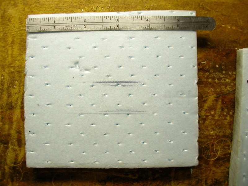

Mike, Thanks! All I had to go on was the picture at the link GPW posted. Not sure what difference the angled nails would make in poking holes in the foam. In the tests I have done the holes are more slots so the angle may make the holes come out round rather than the slots I am seeing.

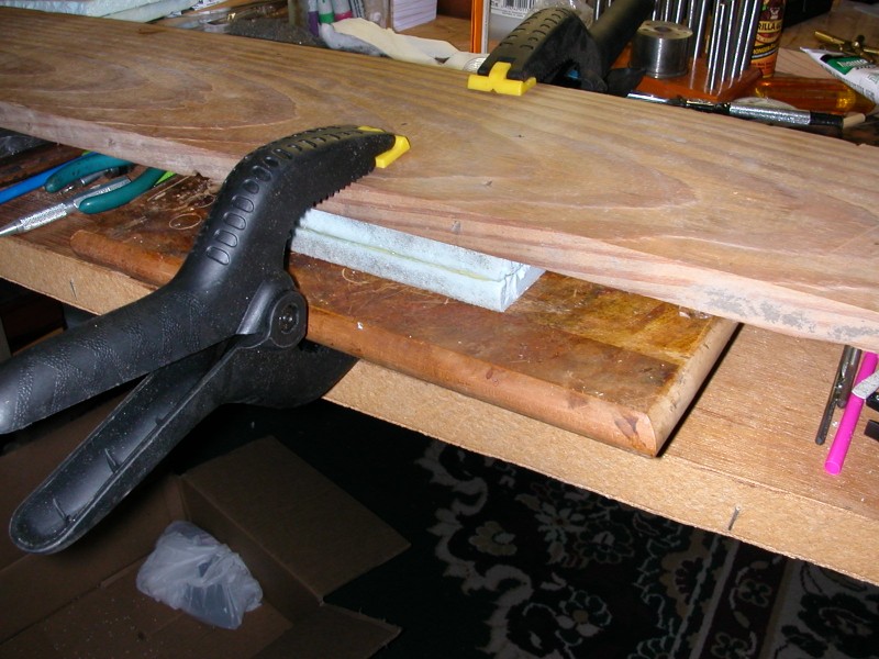

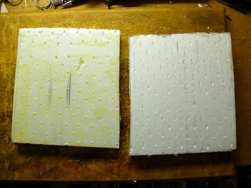

Found one bottle of GG that I was able to break the top open on and scrape enough out to do a quick and dirty test with. Coated one piece with the GG spread on real thin and the other piece with water. Put them together and clamped them. Will rip them apart after it cures to see how the perfs facilitate bonding. As the nails have about 3/8" exposed there should be about a 1/4 inch deep hole in each piece so hope to get a real good bond. Will see.
Below are pictures of the holes with a ruler to see spacing, one of the two pieces, glued, dampened, and ready to put together, and one of them in the clamp, since I know how y'all likes the pictures. ;)

Postby GPW » Thu Jun 16, 2011 7:38 pm
WOW!!! That should Never come apart ... 8)
