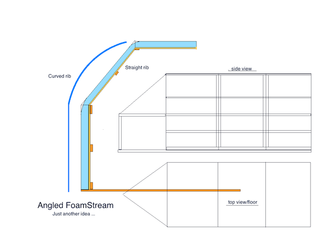

Postby GPW » Mon Aug 22, 2011 10:29 am
Still obsessing over the FoamStream ... Just had an idea to make one angled instead of curved... No ribs other than some 1/4" "joiner strips" ... It would lose the Cool look of the rounded one , but would be easy , requiring no ribs and no kerfing ... and you would lose a modicum of headroom near the edges of the walls , but the top center section could be made wider .. Should be just as strong , much easier to make ... just a little alternative thinking ... Still , the rounded one would be much more pleasing to the eye ... :roll:
Here's a drawing of a half section , angled style ... Image
Not being restricted to exact curved sheets , it could be adjusted to most any size ... even taller in the middle , giving even more headroom without the drag inducing cross sectional area of a more square -ish' cross section ... much akin to a V nose CT , just more "slippery" in the air ... :thinking:

Postby atahoekid » Tue Aug 23, 2011 12:29 am
IMHO, all other things being equal, I'd stay with the rounded look. Much more appealing to the eye. :thumbsup: :D
Mel
"Believe in your abilities... Remember amateurs built the ark, professionals built the Titanic"
"Indecision may or may not be my problem" Jimmy Buffet

Postby GPW » Tue Aug 23, 2011 6:25 am
Mel. yeah , I really like the rounded look better ... just exploring ideas ... although the angled would be easier to make ... and less costly ... :roll:

Postby eaglesdare » Tue Aug 23, 2011 7:20 am
i lile the round vs angle. 8)

Postby GPW » Tue Aug 23, 2011 9:30 am
It is prettier and more roomy ... Should be very aerodynamic and Light .. for it's size ... should be a breeze to tow ... Will try to keep the AUW < 1k lb. less Gear and BEER .... hahahaha :lol:

Postby mezmo » Wed Aug 24, 2011 9:47 pm
Hi GPW,
Just some more thoughts on the Foamstream Construction.
I vote for the original rounded shape. Much nicer looking,
and the angular/flat sided version telegraphs "space constriction".

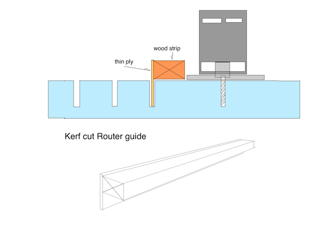

OK, figuring that going with the rounded form , I'll have to do a LOT of kerfing ... :o So came up with a simple guide for the router .. Just some scraps to make the job a little easier ... Image
There’s no place like Foam !

Postby Wobbly Wheels » Mon Aug 29, 2011 12:49 pm
Just a thought here...
In looking at many of the pictures, it seems that (even with expansion of the GG), those kerfs aren't getting filled as much as they could.
Just for kicks, what do you guys think about ripping a bunch of strips on a table saw with the appropriate bevel on either side ?
They would follow the curve like the staves of a barrel or the planks of a hull and (most importantly) would allow 100% area for the glue to bond.
Not that your jig isn't a bit o' genius, GPW !

Postby GPW » Mon Aug 29, 2011 4:31 pm
W2 ,I heartily agree about the V shaped kerfs ... just too many calculations for my little pea brain ... and the eventual search for exactly the right tapered router bit ... Cutting on a table saw would be too much for this old guy to handle ... :oops:
Plus the idea of skinning the inside negates the decorative need to have the kerfs come exactly together ... not that it wouldn't be very COOL to have it do so ... 8)

RE: Foam Kerfs
Postby mezmo » Mon Aug 29, 2011 10:52 pm
How about the cove and bead router bits like they use for building
wooden strip boats? May make a lot of foam-dust though?
And---
Maybe I'm reading it wrong as mentioned, but shouldn't the kerfs be
positioned to the outside? That gives a smooth interior wall and no
worry about interior oriented kerf edges lining up and such. Then
you'd just fill in the exterior kerfs with some judicious amounts of spray
foam from a can, and then cut/sand off any excess of that flush with
the rest of the rigid foam
