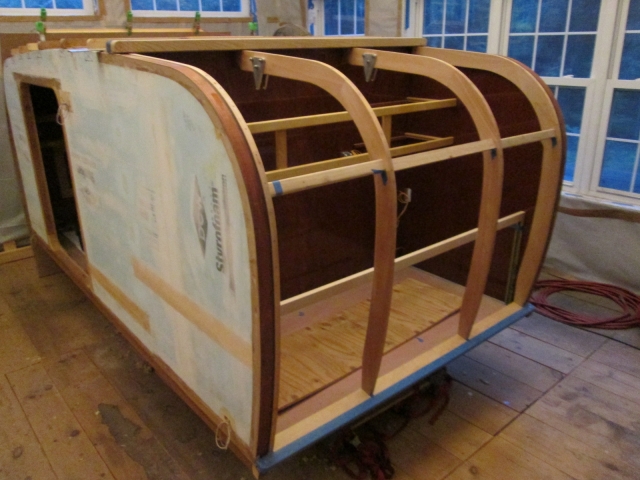

Last night I didn’t get much done, just started laying out a scenario for the rib stiffener/paper towel hanger. Mostly it was SOP (Standard 'O'-voidence Procedure); wasn’t sure I was ready to pull the hatch skin back off yet.

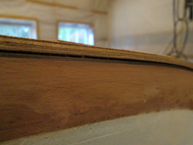

Tonight before pulling the skin off, I tried a couple of different methods to trace a line on the edge of the wall parallel to the underside of the skin. Although I had tried for 1/16 inch gap, in some places it is tighter and I don’t want the canvas to bind. I’ll probably end up hand working the high areas down to the line or maybe take the line, too, to give me a little leeway for pleats. That way when I rabbet the outside edge of the wall where the wall canvas will wrap and the seal will seat, there will also be a nice even gap at the reveal. (I should have given this all more attention in the design phase, but I still haven't pinned down just how much to allow for the canvas.)

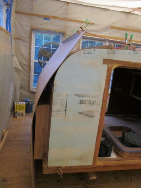

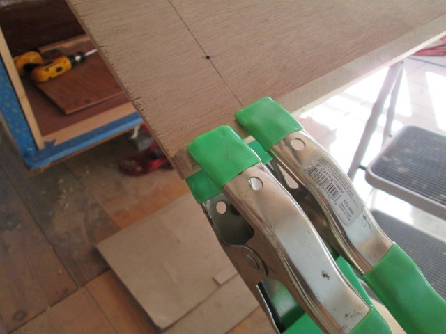

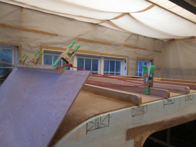

Next I set the drill driver on high speed and spun all of the little screw/wooden washer fasteners out of the skin like little tops spinning madly. The skin had taken a nice set and to try and preserve this I propped it up against the front wall with a board clamped along the front edge to keep it straight. I used the same tether technique just in case.
So now I’m back to here.

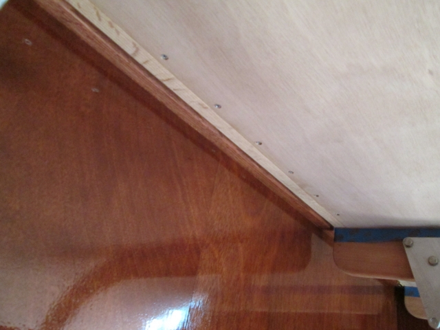

It was about this time that I realized that I never went up under the hinge spar and predrilled for the screws that need to go up thru the skin into the spar in the areas between the ribs. The panel seemed tight enough along this edge, but I suspect that the PL will expand a little.
… and I am getting really worried about how I am going to get the skin back on with adhesive without smudging it all around where I don’t want it. It will definitely take a second set of hands, and then some.
Decided that I need to wait until the skin is glued on and I can cycle the hatch to decide where the paper towel hanger needs to go; too close to the hinge and it will be too far back to reach easily when the hatch is up; too far away from the hinge and it might be too high for the wife to reach when the hatch is up.
I’m at one of those spots where you have to slow down just to be sure you are not screwing up, or painting yourself into a corner, but my goal for tomorrow (or at least the weekend) is to have the hatch skin on permanently.

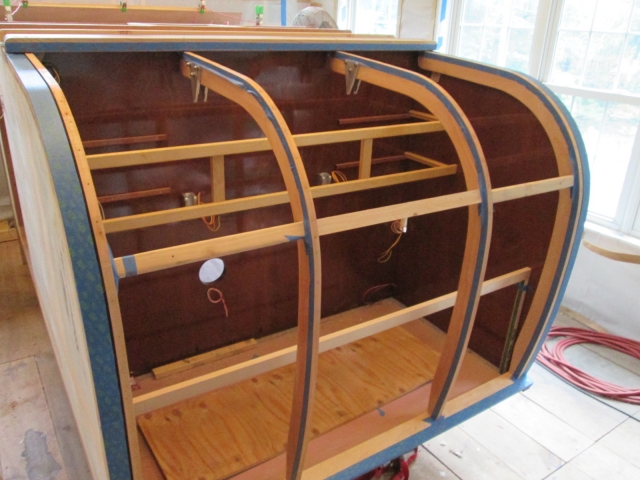

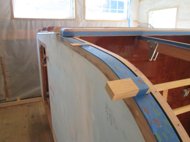

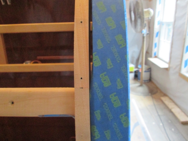

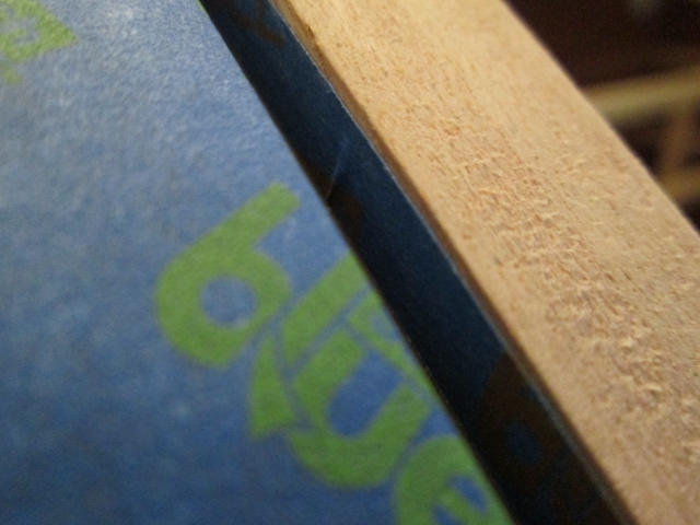

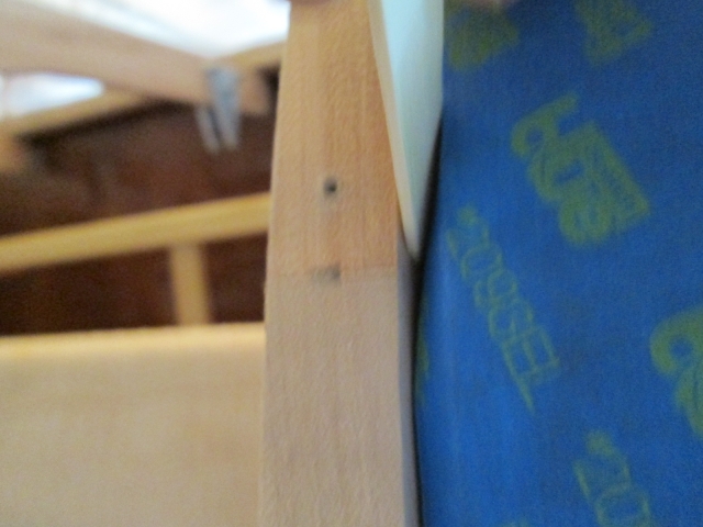

More prep for gluing the hatch skin. I used the almost 2 inch tape along the top edges of the walls. By placing the edge of the tape even with, or just slightly over the edges of the outer ribs, I was able to use a small hobby stick (tongue depressor like Popsicle stick) to fold the overhanging portion down into the gap.
A second pass with the stick (the lighter colored piece of wood at the top of this pic) tucked the flap of tape onto the inside surface of the walls.
Taping the inner facing edges of the ribs was pretty straightforward, just had to do the “squirrel in a cage” routine to get the top middles.
I didn’t think that I would be able to tape the outside edges of the two outer ribs (should have thought to do that before mounting the hatch frame in the galley), but with the success using the stick to tuck the wall tape, I thought maybe I could do a little something. I used the almost 1 inch tape on the tops of the ribs, bridging the gaps to the inside edges of the walls, as before; then tucked the flap of tape onto the side of the rib using the stick; then ran the razor knife using the top of the wall as a guide to trim the tape all along just below the top face.
I have learned that it is far easier to deal with a small even line of glue contact; than it is to pick blue tape out of a pinched joint (the blue tape stands out like a laser beam if you don’t get it all).

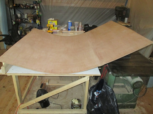

Propped the skin back up on the bench, laid out and predrilled the screw holes along the inside top edge where the skin will be screwed to the rabbet on the underside of the hinge spar.

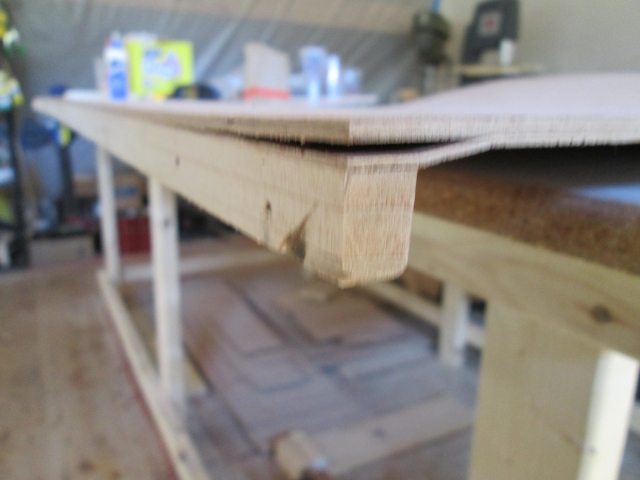

That was yesterday. Today when I went to move the skin, it got away from me when trying to flip it. The bottom edge slid along the bench until it found the gap with the table saw, where it whacked the edge of the saw and I heard a “POP”. The dark mark on the cleat is where it hit the edge of the saw. The glue joint with the cleat held up fine, but it split the first ply back a ways.
Kind of frustrating (select your favorite cuss word here), but not hard to fix. Just forced some glue into the gap, dragged the glue around in the gap with a thin blade, and clamped it up.

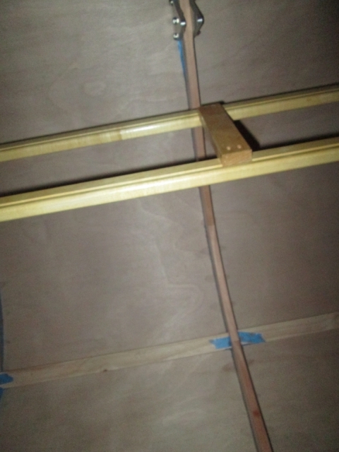

Didn’t even wait for that to cure before stuffing the skin back under the hinge spar to predrill for the screws there (squirrel took this picture after driving all of the screws for a dry run).
While I had the skin up there I placed these temporary spacers on the walls in the hopes that, once I had the ribs all coated with PL, I would be able to get the front edge of the skin under the hinge spar and positioned before setting it down on the ribs without smearing glue all over the underside of the skin.

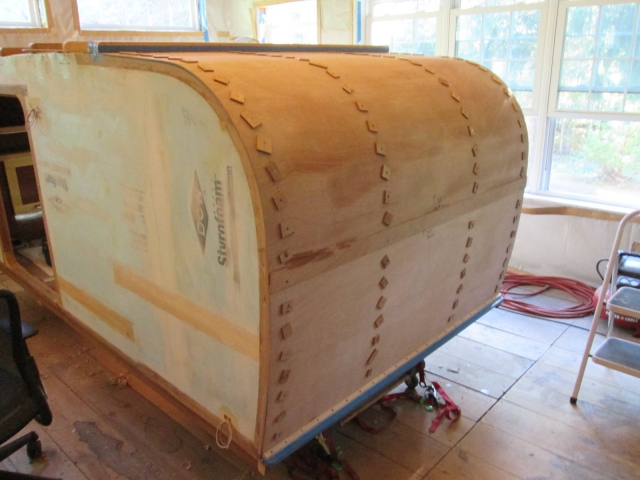

Well, there was no time for pics during the actual glue up. I used the home made notched credit card to spread PL Premium along the top front edge of the skin and on the tops of the ribs; stuffed the front edge and screwed the four deck screws down thru the spar and skin into the ribs; then climbed under into “the cage” and screwed up thru the skin into the spar all along the front edge. Unfortunately, I wasn’t able to control the skin well enough to keep it on my spacer blocks (Karl was on the road doing an install), so I had a couple of big smudges of PL get on the field. I kind of predicted this, so I had already staged a paper towel damped in spirits, and while I was in there I wiped it off as best that I could.
Next it was back outside where I started driving all of the screws down into the ribs, removing the spacer blocks as I went. When I reached the tighter radius I applied glue down the back sides of the ribs, spritzed the ply with water and continued screwing. There’s no glue under the cleat at this time, but I did screw it to the lower hatch spar to make sure that the skin was tight all the way to the bottom.
I stuck my hand thru the vent fan hole in the bulkhead to get this pic looking up. You can see some of the water marks from previous soakings seeping thru the screw holes, but experience suggests that these will be unnoticeable when the stain goes on.
