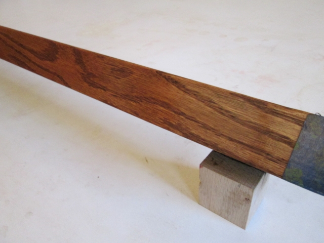

Here are a couple of shots of the cabin hinge spar with the first coat of poly from the other night. I had set it up on a V-block to make it easier to brush the two sides that will be exposed in the galley.

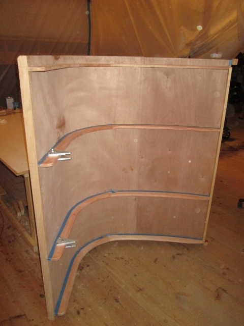

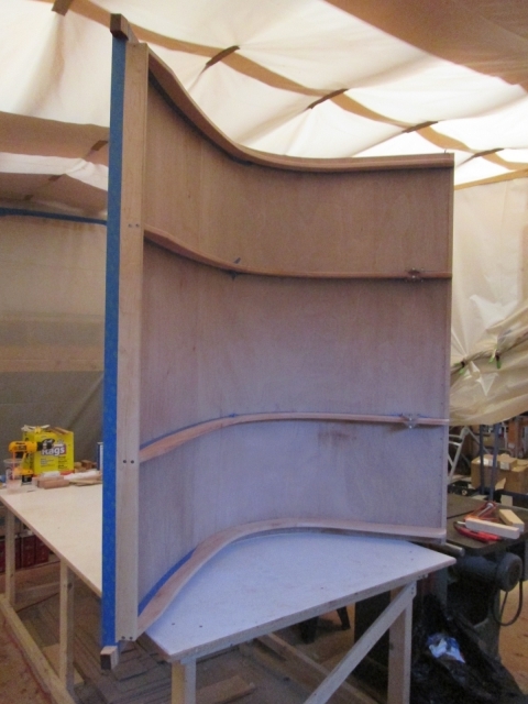

I started tonight by removing the temporary screws holding the bottom of the hatch to the cabin. On top of the 1/16 inch gap that I had set, there was about 1/8 inch additional spring out at the very bottom on the street side; totally acceptable and within what the draw latches should be able to handle.
On the curb side there was less than 1/16 inch change.
Just a little way up on either wall there was no additional gap.

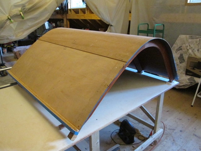

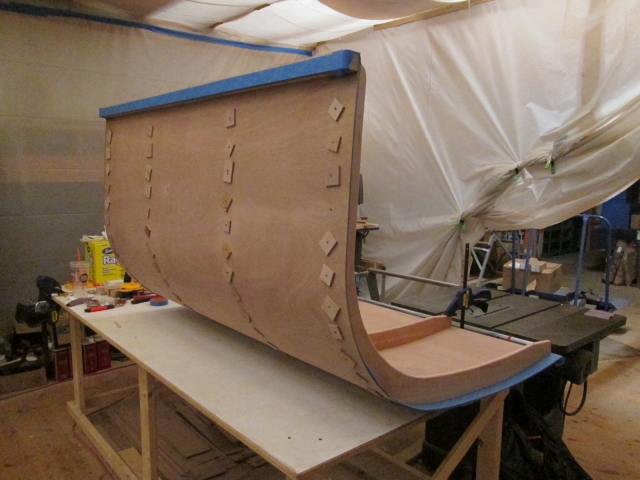

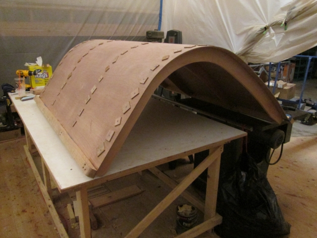

Next I undid the temporary screws at the top and Karl helped me flip the hatch over onto the bench.

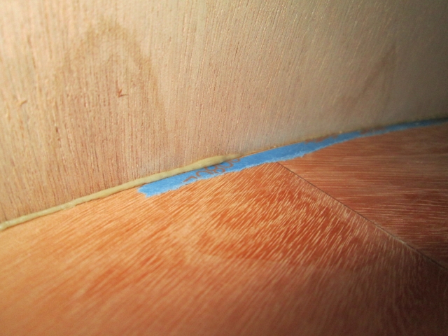

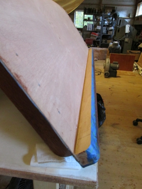

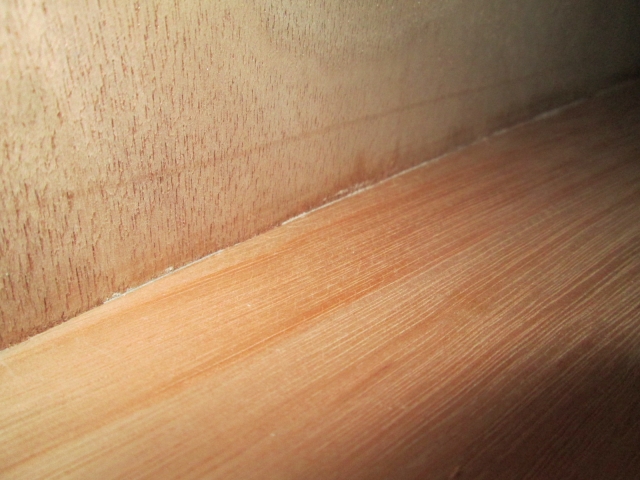

In this fuzzy pic you can kind of see the PL squeeze out and tape that now needed to be cleaned up.
I spent the rest of the evening, about 2-1/2 hrs, with the extended razor knife cutting and scraping until I got about halfway thru the job.
After experimenting on the outside of the first rib (end of bench in the above pic) I decided that things would be more stable and accessible if I stood the hatch on edge. Now that I had access to grab onto the ribs, it was much easier for me to maneuver the hatch by myself… still very reasonably light.
First I would pull the tape…
… then cut the squeeze out with the razor guiding along the rib, then complete the cut by guiding along the skin. Trim a little closer then scrape some using the tip of the razor laid into the corner of the joint. In this close up you can see the white line that is an artifact of the PL (won’t go away).
Stand back a little and it doesn’t stand out so much.
Stand back a little further and it looks better still.
I just hope that the stain doesn’t highlight the whiteness.
Moving on I set the hatch down onto the floor to get the next couple of ribs, then flipped it over and started working my way back on the other sides of the ribs; which is where I quit for the night.
Very tedious work, but it “must” be done.

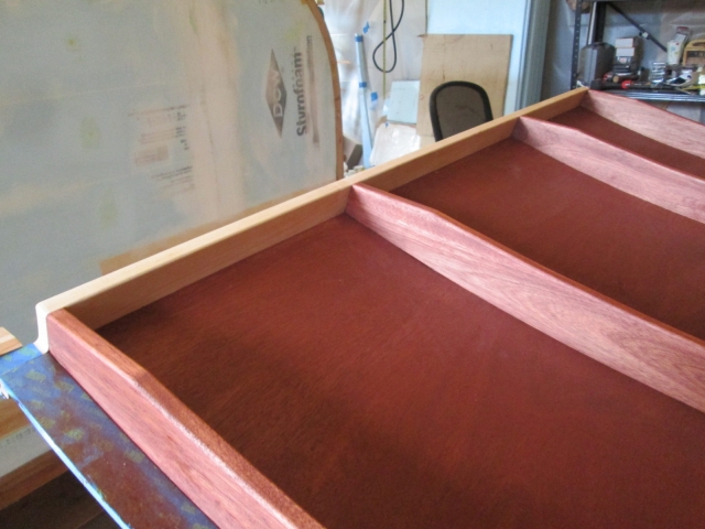

Postby KCStudly » Fri Oct 17, 2014 11:51 pm
Thursday night it was more picking PL on the hatch ribs and hatch hinge spar. Karl reminded me that I could use a thin-ish chunk of the blue foam to act as a flexible semi-firm sanding block. I used this on the curved underside of the hatch skin to get rid of the big stain where I had smudged PL. Since I had wiped it with spirits, it wasn't to bad and cleaned up pretty easily.

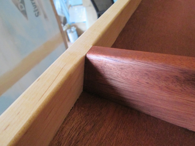

Less critical, but still needing attention, was the inside corner between the outside of the skin and the back face of the hinge spar. Had to flip the assembly again to clean the blobs there (wouldn’t want them to interfere with a nice tight fit on the foam).

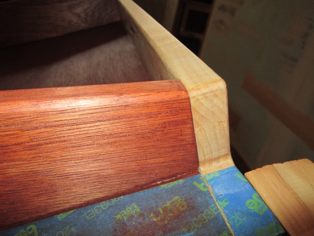

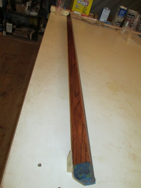

Tonight (Friday), before removing the lower spar (in natural maple stain) so that I can stain the inside of the hatch (Red Chestnut), I started by masking the areas around the bottoms of the ribs. This will be for when I glue the two back together (glue will be after the stain, but before the poly). Here you can see it after I removed the spar and trimmed the tape from under the lower skin cleat.

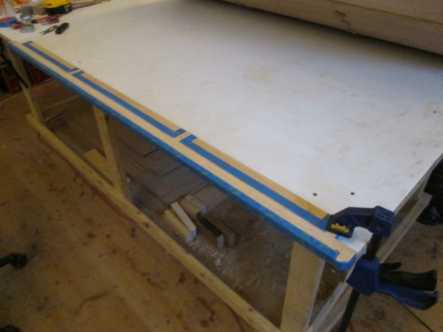

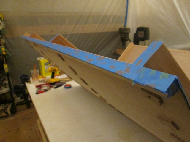

Then I set to work masking the raw wood on the hatch where I don’t want stain to interfere with future glue bonds. First the bottoms of the ribs and lower cleat.
Then the edges of the skin outside of the ribs where the canvas will wrap under.
Then along the top of the hinge spar where the canvas will be captured under the hinge.
Of course, all along the way I have been finessing this here and that there; looking closely here and there, hoping to get a nice finish on the underside.
Tomorrow I will remove the upper actuator brackets and apply the Red Chestnut stain. Maybe put another coat of poly on the cabin side hinge spar.

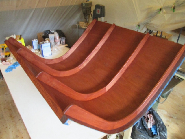

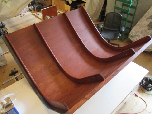

Postby KCStudly » Sat Oct 18, 2014 8:19 pm

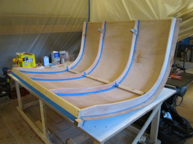

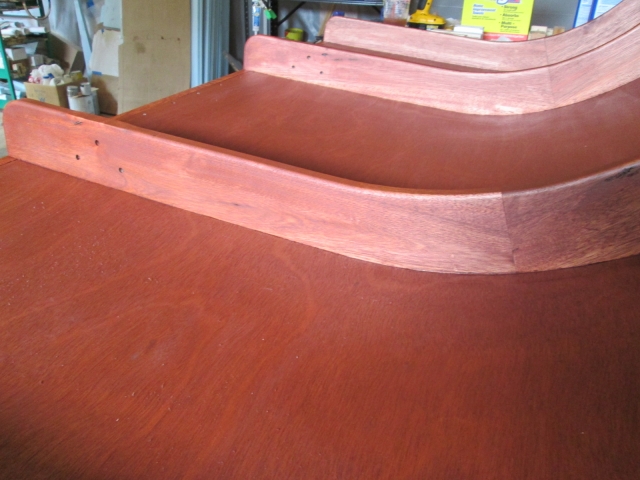

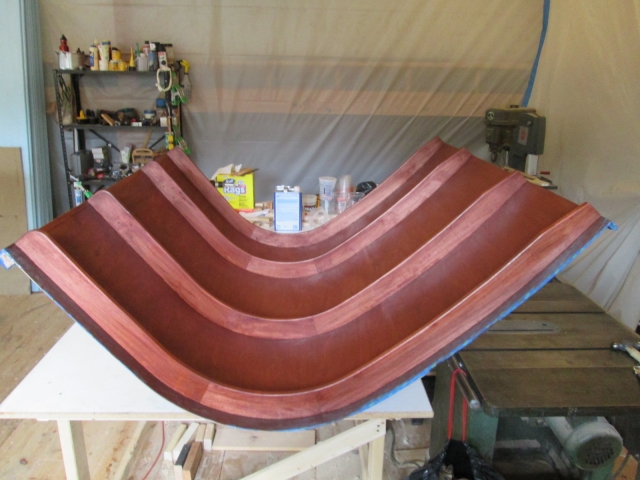

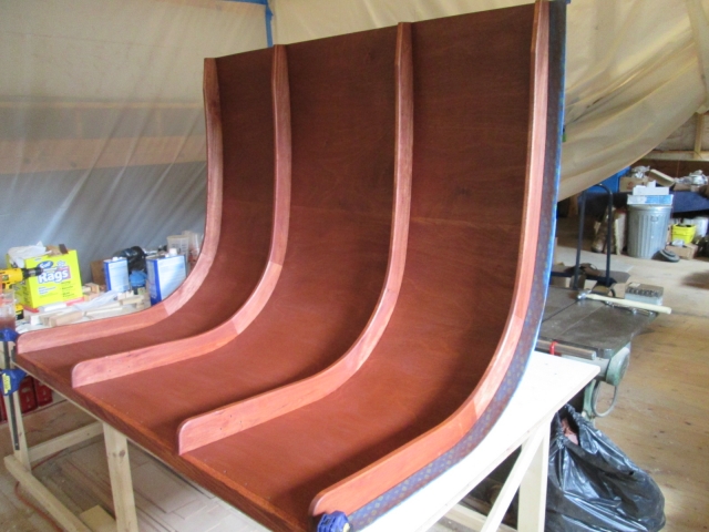

Jumped right in, removed the upper actuator brackets, and put the stain on the inside of the hatch.
Then rubbed it out.

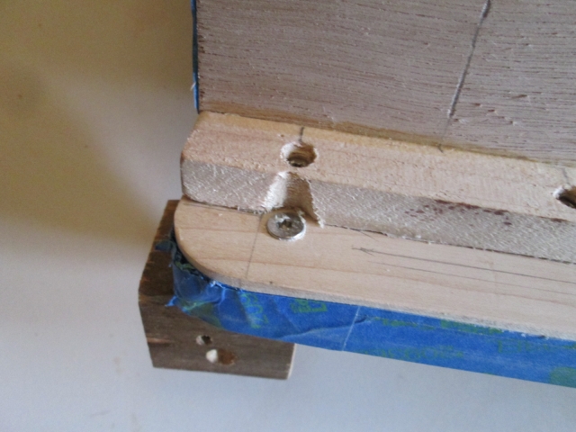

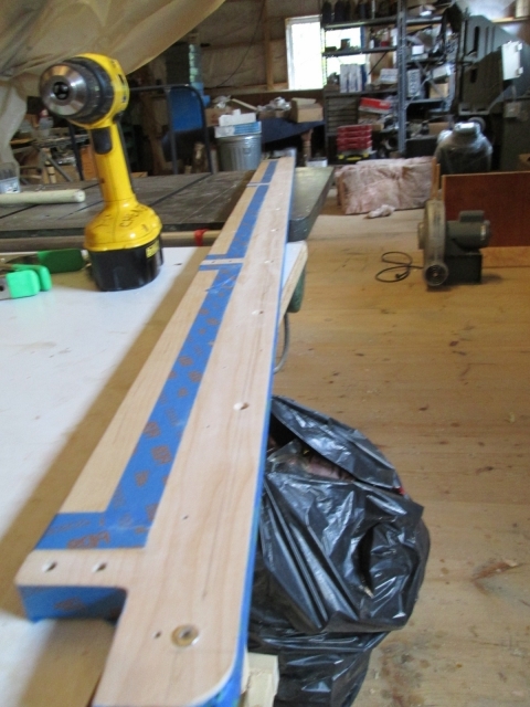

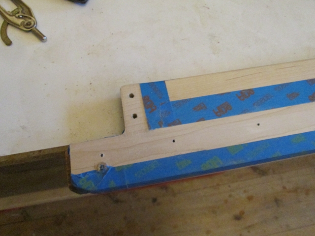

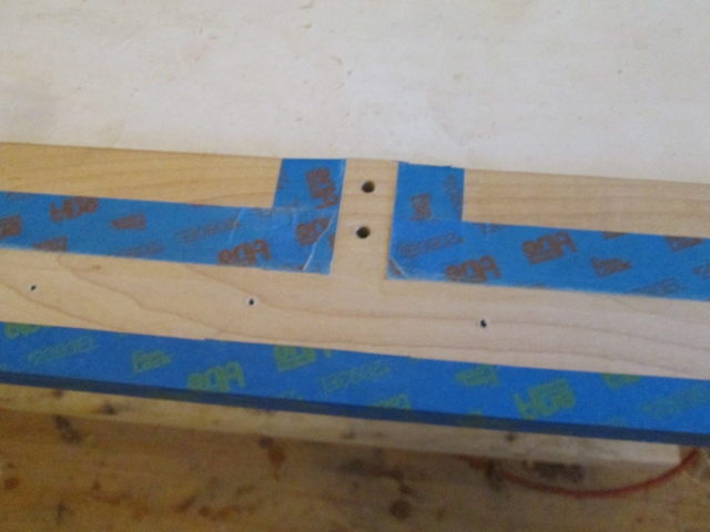

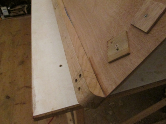

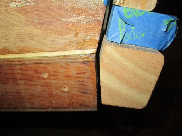

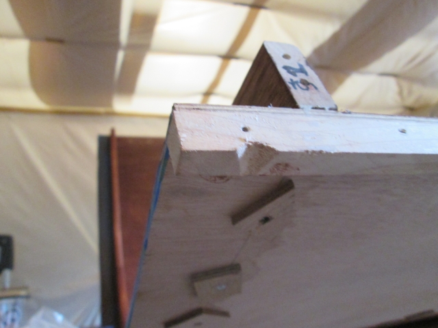

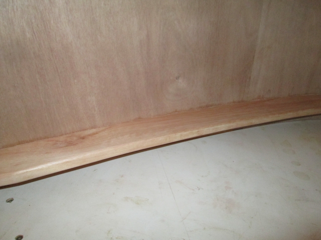

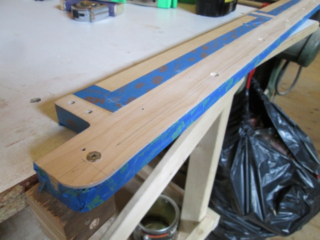

I almost got ahead of myself, getting ready to glue the lower hatch spar onto the bottom of the hatch. Fortunately I realized that it would be easier to pre drill the top of the spar for the rest of the bumper screws now. Also, when I put the screws down thru the ends of the lower hatch spar (to hold the temporary screw blocks with the intent being to reuse these holes for the bumper, too) I hadn’t yet worked out the details of the cleat at the bottom of the inner skin. Those two screws ended up slightly under the edge of the cleat. I had noted this during the dry fitting, had intended to make a couple of clearance notches, and am glad that I remembered that before proceeding.
So here I have trimmed the masking tape off of the top rear of the lower spar, adjusted the line for the bumper screws back a little, and drilled the rest of the holes.

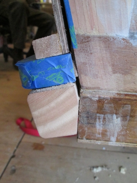

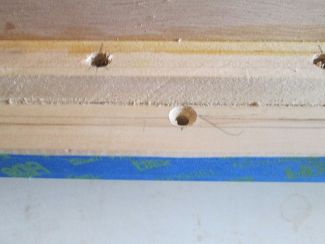

You can see how close the head of the end screw is to the small hole from the cleat screw.
With the hatch laying on its back on the bench, I used the nose of the big sanding block with very coarse grit to quickly notch the cleat at both ends.

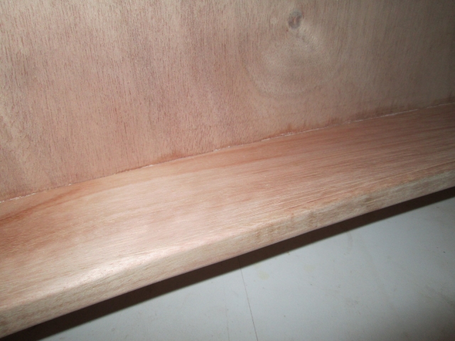

I secured the hatch on the bench with the bottom hanging off in such a way that I could attach the spar and still drive the cleat screws in from below. After spreading the PL on the spar I put the relatively long screws that go up into the bottoms of the ribs thru a couple of the holes. By hanging the spar off of these two screws first it allowed me to start all of the screws before pressing the joint together, and helped keep me from smudging PL all over. Once I had all of the screws started by hand, I ran them up a little at a time and secured the joint. From there I sat down on the floor with my back to the bench and shot the cleat screws up and in.
After using the wooden stick and a bit of paper towel to wipe up the small amount of squeeze out, and pulling the masking tape, I went back with the needle from my little pencil compass and scooped up a little more squeeze out. I am more than pleased with how this went.
Here’s how the little notches in the cleat worked out.
And how the relocated bumper screw holes worked out.

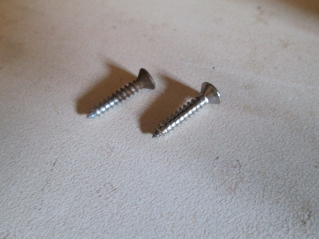

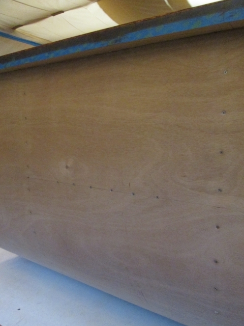

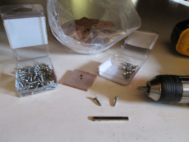

When I screwed the hatch skin onto the ribs I used a combination of bright zinc plated steel screws and stainless steel that I had on hand (all #6 x 3/4), but I knew from experience on the cabin front radius that even the brief exposure to water from soaking the skin would start the steel screws rusting.
So I had picked up a couple more packs of the SS screws to swap in when I went to remove the temporary wooden washers. The SS screws appear more silver, while the zinc plate has a bit of a blue-gray tinge. Just to be sure and to speed the process, I used a magnet to cull the steel screws out.
Remember Pinhead from the Hell Raiser movie series (Warning: Link contains disturbing graphic images)? Well, that was what all the wooden washers reminded me of, and I was pleased to remove them one at a time; 90 out of 96 of them.
I came up half a dozen screws short, so need to pick up another pack.

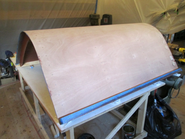

Lastly for today, I trimmed the excess masking tape from the rear face of the hinge spar in prep for foam.

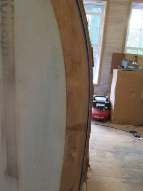

Today I started by swapping out those last few screws in the hatch skin and removing the last of the wooden washers.

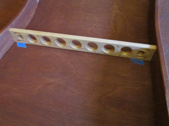

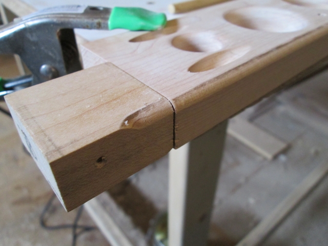

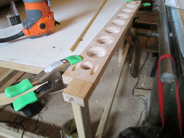

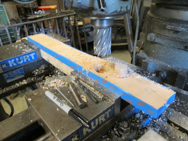

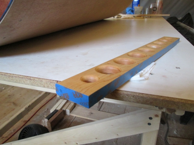

I decided to compromise on what I’m going to call the Paper Towel Brace (PTB). Rather than hanging the hatch again and going to all the trouble of getting the actuators to work in order to decide where to place the PTB, then having to take the hatch back off to apply the poly; I decided to make an educated guess and just screw it in place w/o adhesive. I can still pull it out, sand the hatch stain and glue it back in, or even move it later, but for now it just made sense to do it this way.

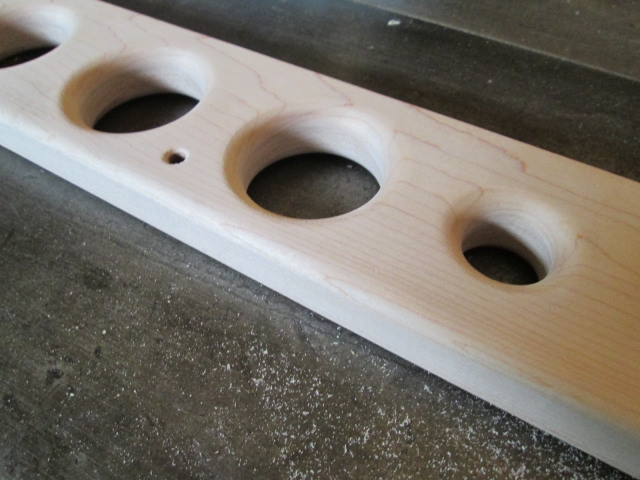

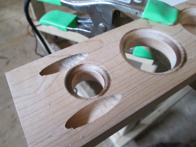

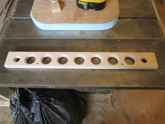

Here we go. I had already cut the 1x3 maple to length, done my layout and put the pocket screw holes on the “back” side. Here I have masked the edges, backed the blank up with a 2x3 to avoid breakout, and have core bored the first of seven 1-1/2 inch lightening holes. The plug (or core) is shown next to the hole.
The two smaller holes on either end sort of give a tapered look, but also fit between the pocket screw holes on the other side. The two much smaller holes on either side of center will be where the actual paper towel hanger will attach.

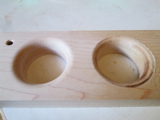

There are a few things going on here. First, the small hole for the towel hanger has been chamfered. I plan on using paracord for the hanger; the cord will be knotted on the back, will pass thru the hole, and will hang down in a loop for the towels (perhaps being threaded thru a length of SS tubing, and with a wire hook on one end to make changing rolls easy); the chamfer eases the edge of the hole so the fibers of the cord won’t fray. The large lightening hole on the right is as routed, and the one on the left is after hand sanding with 220 grit sand paper.
I rounded over all of the holes on both sides using the 1/4 inch round over bit, except for the backs of the smaller holes where I used the 3/16 radius bit (to avoid encroaching on the pocket screw holes).
The upper edge of the PTB will be hard up against the hatch skin, but the lower edge needed to be rounded over. Since the hatch ribs are 3 inches deep and the PTB is only 2-1/2, I wanted the edge radii to butt into the sides of the ribs. To keep from accidently rounding over the end of the blank I used a scrap of wood and one of the pocket screws to act as a waster to start and finish the router on. (The dowel was used with a piece of sandpaper wrapped around it in order to sand out the discoloration from drilling the pocket screw holes.)

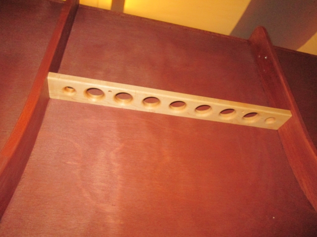

Here it is all sanded out.
Here it is with glue edges masked (still hadn’t decided at this point) and natural oil stain.

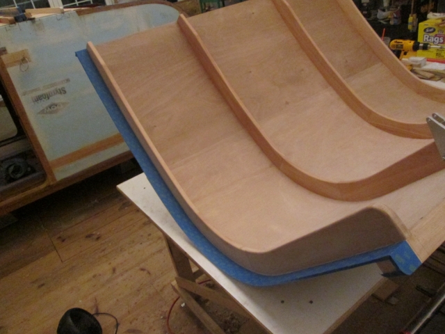

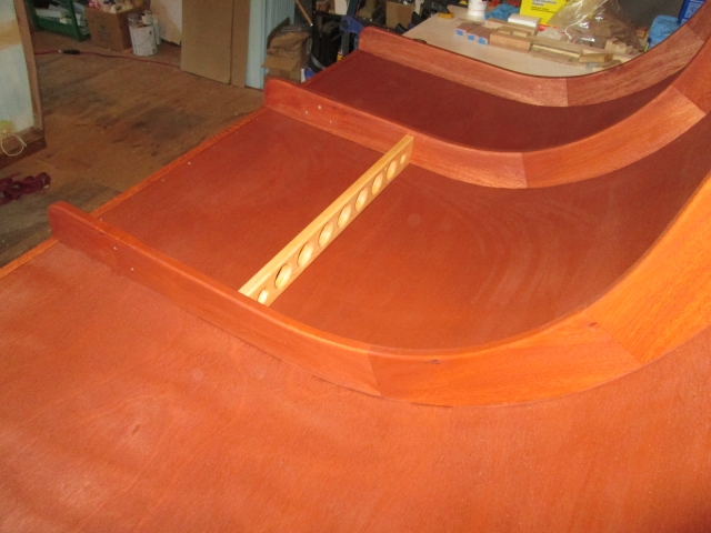

Looking at the underside of the hatch from the hinge edge, I measured to a point where I hope the roll will dangle and perhaps drag on the “front” rail of the upper galley shelf. If I got this close to correct, the rail will act like a friction brake and will keep the towels from stripping off in the wind. If not I will add a bobble on another piece of cord that will perform the same function. Here I have placed blue tape at 14-1/2 inches from the edge of the hinge spar to act as a guide for locating the PTB. I had to press out slightly on the ribs with the palms of my hands as I pushed the brace down with my fingers. The tape kept me on track; once the brace was seated it was a snug fit and I didn’t want to move it around too much for fear of scratching the finish.
Another thing to note in the above pic is the dark shadow showing how the skin is bowing away from the brace. At this point I drove the pocket screws in to pin the location, then measured carefully to locate screws that will come from the top of the skin and land between the lightening holes; the horizontal row of screws in this pic.
That sucked the skin up nice and tight to the brace.
