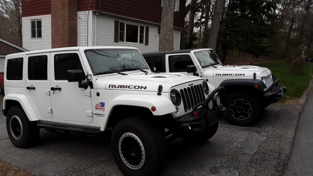

Not sure if I’ve mentioned that the black Jeep and the Ford have been sold. I had been thinking about selling the Ford before things started going wrong with it… then, a month later, things went wrong with it. Electronic steering assist went out and, with some other upkeep issues, basically cost what it was worth to fix.
Since Yvette and I had been sharing the 2016 Hard Rock and enjoying it, I figured, why not get another one?
Dueling Hard Rocks.
It’s a 2017 Jeep Wrangler Unlimited Rubicon Hard Rock Edition. Loaded with similar features and add on extras like the 2016. It’s an automatic with the semi-auto manual override feature (i.e. a slap shift feature that holds gears when in manual mode). It has larger than stock tires (285/75-17, equivalent to 33.8 inch tall) on MOPAR “Bead Lock Ready” wheels (the trim rings can be replaced with proper bead lock flanges). It also came with a full set of five of the factory wheels (which is how I found the for sale ad; I was looking for take off wheels to match the camper to the 2016). This one has the factory head unit with built in GPS (but no backup camera… will have to add one on). Has body color fenders and Freedom hard top, and came with the soft top new in box, never installed. Already has a receiver hitch and 4-wire trailer hookup installed. Anyway.

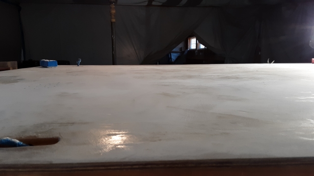

On the camper, last year at about this time I tried to get active again, attempting to address the blisters on the street side wall. I had some success, but not enough to fully quell my discouragement.
In the next pic, looking from the top of the wall with the edge of the galley to the left, you can see the lighter patch to the left, surrounded by yellowish/clear epoxy. This is one of the “original” blisters that I fixed by drilling a series of holes thru the outer FG skin using a drill stop; then hand twisting the bit in each hole down thru the foam until I reached the inner plywood skin; then syringed neat epoxy into the holes, palpitating to move the epoxy around; then weighed down a flat board with packing tape release. The excess epoxy oozed out of most of the holes (resulting in the yellowish/clear cured layer), but not all of the holes stayed full. The whiter colored patch is the result of skimming with epoxy fairing compound and sanding back.

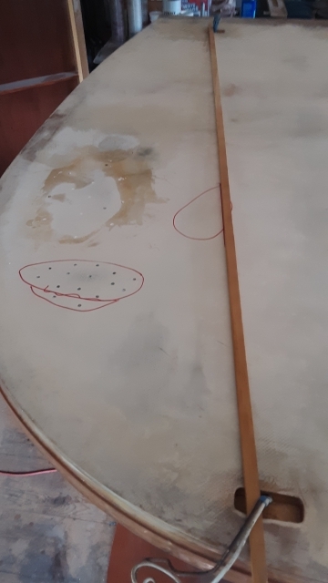

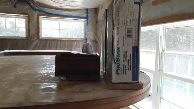

While sanding this back, the two areas circled with red sharpie were discovered. More blisters. Now I can’t be sure if I just hadn’t noticed these before (? seems unlikely), or if they were newly developed. One concern was that they could be cropping up from the pressure of sanding somehow causing delaminations; but that doesn’t track when you consider that some of these blisters were springy/spongy before I drilled them, and then weren’t afterwards (as if some gas build up was making them puff out. In the pic you can see the circled area to the left that has been drilled, and the one near the batten yet to be drilled. The batten is aligned between the running light wire way at the base of the wall (top of pic) and the clearance light wire way at the top (bottom of pic), showing the wire path between them and where not to drill.
In this pic looking back the other way, with the sun, you can see how horrible the body work appeared at that time.
Here are the boards with weights trying to keep the blisters flat while the injected epoxy cures. Not totally successful, some oozed out and settled under the slightly warped board creating more opportunities to sand (will this ever end?)

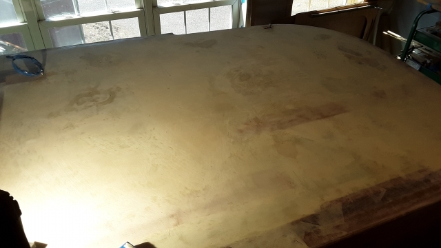

So while sanding that back fair and the rest of this general area, I found an area in the middle of one of the previously “fixed” areas, and another adjacent area, that were still soft/sticking up. You can’t just sand these areas because the blisters stick up; when you sand it the skin gets thin and you still haven’t sanded and faired the surrounding area. Discouraging.

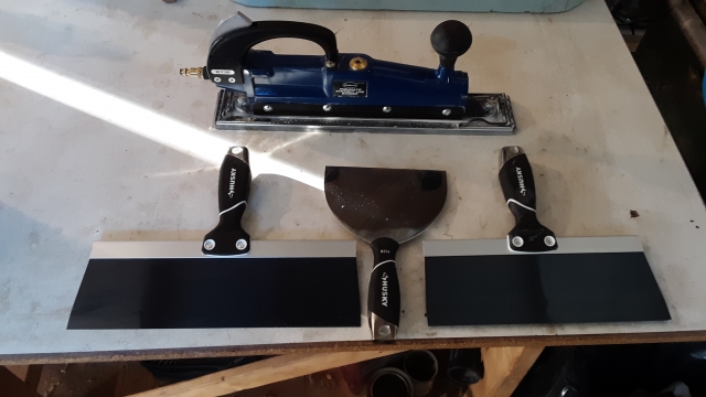

Okay, I’ll bite. What else can I “load my gun with” for success? Many have advised that I use steel plaster spreaders. And, instead of hand sanding, switch to a pneumatic long board, referred to as a “file” in tha’ bis-ness.
So I got these.
Strung two 50 ft air hoses together from downstairs and got set up this morning.
Now, most of the roof and the area behind the door on the street side have already been mostly done with the 410; and Karl and I had already laid the cabin over on its side to try and mitigate the sagging issue. In fact I was considering mixing a much thinner batch of the 410 in the hopes of it being self leveling. But I figured the hatch (which is curvy and not possible to orient with the whole surface horizontal) and the front wall with front roof radius (that can’t be turned up enough to lay flat) would be good areas for the Total Fair. If I like it I can use it on the curb side wall, too.
Anyway, rather than mix epoxy and try to fix the two small areas, then have to wait til it cured, I decided to try out the air file on the rest of the rear portion of the wall. Hard to see, but after just a few minutes work it was already looking, and feeling, much better.
With the two tub vacuum setup I was able to put the separator tub up on the scaffold with me, but the power unit had to stay on the floor. After climbing up and down a few times to turn the vacuum on and off, that got tired; so I got smart and used a stick to reach the switch.
After a couple of sessions, only a few minutes each; followed by rest periods and vacuuming the dust (always wear respirator and goggles) it was already looking much much better.

Hi KC! The progress you’re making on the PCE is significant. Sounds like you have been learning a lot and implementing some changes to your process to hopefully permanently eliminate the blisters. I hope they stay gone this time! I can imagine how discouraging it could have been when they just kept appearing, no matter what you did and how much work went into it. Fingers crossed that your trailer is over that hump now and you can move on to part of the build that is much more fun.
I really like the two matching JK Rubicons. Very cool. Do you and your wife take them on wheeling trips together? I am interested in what kind of communication setup you have to be able to talk back and forth. My Jeep has a CB in it but from what I hear and read, a GMRS radio is the way to go these days because it is as easy to use as a CB, but with tons more range and better clarity. I am thinking about upgrading that at some point, but probably not before whenever the next Jeep trip is (not on the calendar yet).

I would have taken the 2016 on the last Unimog run, but the wife wouldn't let me, too new and didn't want me to break it.
It is surprising hard to find places to wheel around here. Despite all of the wooded land, it is all private property.
No coms in the Jeeps, though we have used walkie-talkies in the past. Both have hands free cell connectivity/wifi, so when service is available that would be an option.
Thx again for the shout out!

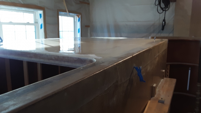

This is going to sound a little familiar. Today I washed amine... then did a little research on compatible guide coats while letting the surface dry well (after wiping with paper shop towels). I used the small block with coarse sander belt scrap to dig down and blend any low spots that didn't have well feathered edges. Next I splattered a guide coat of primer from a spray bomb held way up high, like 3 ft above the surface. Let that flash off a bit, and then hit it all with the jitter bug again (my longest session so far, creating lots of fine sanding dust). The first piece of sandpaper I had applied to the board and was still using started to clog up from the primer (which was mentioned in my research), but a fresh strip of 80 grit settled that problem and I was able to knock it all, mostly, down pretty well.
This left only some areas around the galley wall edge in way of the hatch, around the light recesses (details that I had purposely left until the "end"), and a couple of well defined areas in the field that still needed attention.
Vacuumed sanding dust, wiped with paper shop towels and acetone, and mixed another 2 pump batch of thick 410 fairing filler. This pure batch (i.e. no 403 filler) went on well, better than Bondo, and with a better working time. At first I just used the stir stick to get it out of the mixing cup and daub it on in the general areas of interest in approximate amounts, then I struck the bigger areas with the 12 inch knife. Worked really well, and was easier to get right than the looser mixture (should sand easier, too). Then I used the 6 inch knife to work the smaller areas near the light recesses and the edge of the galley wall.
That only went so far, so I mixed up another 1 pump batch and did pick up of most of the rest of it. As the areas of interest are now more defined and separated, and with the thicker mix, I wasn't so prone to messing up one area when working the next.
There were still some small areas needing filler along the edge of the door opening and in the transition to the door header and footer, but I will get those when I mix up a larger batch and move on to the front area of this, the street side wall.
I think after one more round of amine wash, jitter bug and detail sanding, this, the larger rear area of the street side wall will be ready for sealer coats of neat epoxy, which I will do with the whole wall when the front and door area are brought up to this same level of fairness. Not perfectly flat, but not lumpy bumpy, either.
I had thought that I might test out the Total Boat fairing filler on the tongue box or fridge lid today, but after 4 hrs with fewer rest breaks, I was ready to call it quits for the day. I think I forgot to mention that the Total Boat is supposed to cure to a sandable state in just a couple to three hours, whereas the West System slow can still sand into little worms the next day (maybe 12-18 hrs later).
All in all, it was a good day, and I was buoyed by the improvement in my results and technique development.

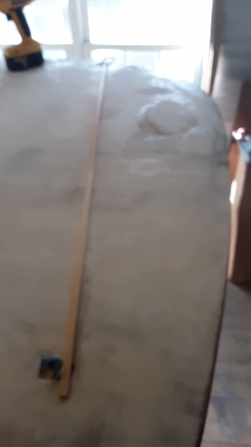

Yesterday. Well the back part of the wall wasn't as well finished as I had thought, still quite a few low spots.
Another round of washing amine; jitter bug; vacuum; and acetone wiping/de-greasing.
Rather than just do a few smaller areas, I prepped the front portion and around the door and set up to do a larger 5 pump batch.
The 410 filler wasn't the best at filling the blister repair drill holes... they kept pillowing up, again suggesting some sort of gassing or heat expansion, so when sanded back there would still be a hole. And there was a blister repair on the front area, too (still the street side, toward the front about level with the start of the roof radius). So I mixed up a small two half inch worms of 3 min epoxy with the 403 structural filler and pressed that down in the holes. This was thick enough and sticky enough that it did not pillow out, and only took a short time to harden enough to sand fair.
Focused application of the larger batch of 410 on the front section, laying it on thicker this time (maybe 1/8 inch max... probably less) not trying to scrape down to the weave. Whatever was left over I stretched out hitting most all of the areas on the rear section of the wall that still needed some pickup.
