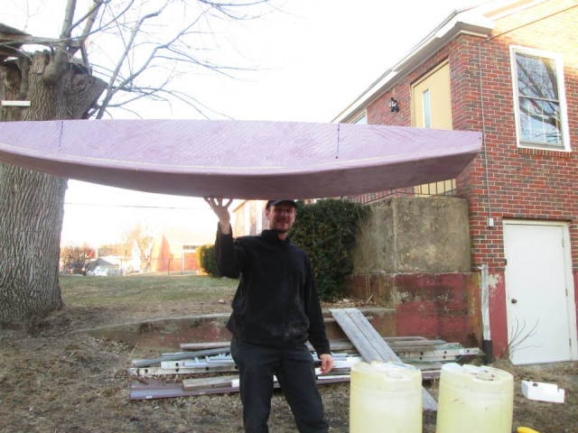

Postby rowerwet » Sun Mar 30, 2014 5:36 am
after a half day at work I got back to the foamiemouse, I found the drywall screws work great as clamps and alignment dowels. Sucking the bottom panels down to the sides just fine.

I was trying to balance it on one finger, but there was too much wind

Postby GPW » Sun Mar 30, 2014 5:41 am
Now that’s a LIGHT boat ... :o 8) 8) 8)

Postby clermont cubby » Mon Mar 31, 2014 9:14 am
Great pic of you balancing foamie. :D :D
