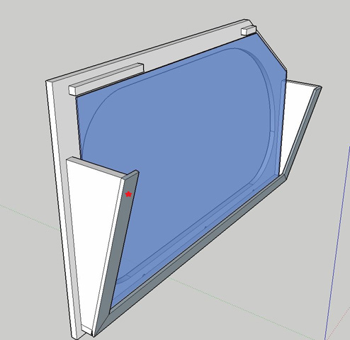

Brushy_Bill wrote:Weep Holes ... How big did you make yours, and how did you seal them? Did you use "the mix", or paint on the inside of them?
I would be concerned about the edge of the canvas at the circumference of the hole. Folks spend time painstakingly wrapping and sealing edges and corners of the canvas, and then drill a hole through it.
Is there any kind of "draft angle" (sorry, a casting/die making term) along the bottom exterior edges of the window openings to help keep water from running towards the glass?
I drilled the hole slightly larger than the 5/32 (inner dia) brass tube that I epoxied into the hole. There is no way to get a Q-tip in tube that small but I find that a squirt from a spray bottle clears them very well. After the weep holes were drilled, the entire window is water proofed with "the mix". Then I epoxied the brass tubes in making sure to have plenty of epoxy and no gaps where water could infiltrate. Then Behr's best outdoor latex paint was used to paint the entire frame. I'm absolutely sure this solution will work for New Mexico but if I lived in Seattle, I might take more drastic waterproofing options. I think the board member Rowerwet has this style of windows and lives in a much wetter climate. Maybe he will weigh in? The problem in New Mexico is dust! We have no rot or rust but boy do we have dust!
The canvas at the circumference for the window hole is doing great because I made sure it was glued down well before I cut the hole and then I spent more time making sure edge was glued down after the hole was cut. Again, this may be working well because I am in New Mexico but it does seem like it is really stuck down. No signs of the canvas edge trying to lift.
I used an 18 degree slope for the tray that the window sits in so that the water would run back out. That's a steep angle in the plumbing world. I figured I would most always get the trailer to level within 15 degrees so even on a slope it would drain.
When the windows are closed, a negligible amount of water even needs to drain. The window pane overlaps the hole by about .5 - .75 inches on all sides and even spraying it with the hose directly doesn't force much water between them. I haven't had them open in a blowing storm yet, but I have a several regular rain storms. Surprisingly little water makes it into the tray when the rain is coming straight down (more or less).
I don't have a good drawing of the window design but here is one of my early shots at drawing one. I hope it helps. It doesn't look like the tray at the bottom is sloped but it is. I also didn't need the tabs at the top to keep the window from sliding up. The star denotes the rail that is removable because at the back of the trailer there isn't enough room to take the window pane out of the frame by taking it out the top.
