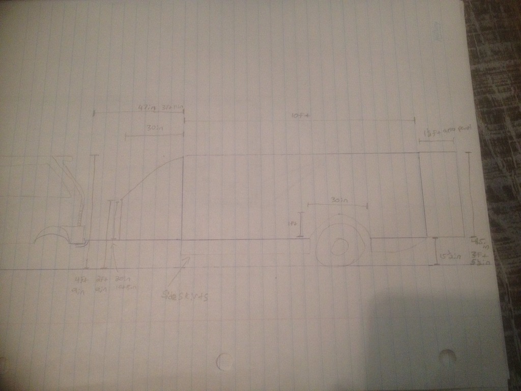

If you want to see plans i made they are in that thread above, just skim though for the pictures, heres 2 quick drawings from it.
