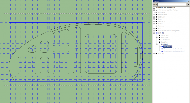

It is a very percise program. The trick is knowing how to use the program to get precise measurements. When you make your initial side profile make sure to save that in a layer by itself. You can then create a grid layer over the top of the profile layer. I used a 2 inch by 2 inch grid over my profile. I then took measurement of various points in SketchUp and layed them out on the plywood. I little time consuming, but very accurate results.

Postby WhitneyK » Mon Jan 28, 2013 4:45 pm
danlott wrote:You can then create a grid layer over the top of the profile layer. I used a 2 inch by 2 inch grid over my profile. I then took measurement of various points in SketchUp and layed them out on the plywood. I little time consuming, but very accurate results.Dan
How/where do I find this "grid layer"?

Postby danlott » Tue Jan 29, 2013 2:12 am
I created the grid layer. Just make a bunch of lines spaced equally apart. When you have the grid created you can group all the lines together and the assign the group to it's own layer. You can then move the grid layer over your profile. After that use the measuring tool to measure various points of your profile as compared to the grid.

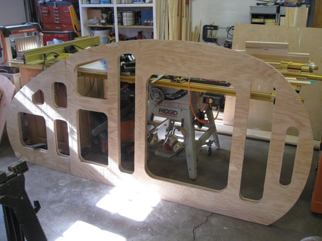

Postby _Ryan_ » Tue Jan 29, 2013 9:29 am
Instead of lines you can also use guides. Create a rectangle that defines the outer edges of your profile then use the measuring tool to drag guide lines out every 2 inches. This rectangle can also be the size of the plywood you are cutting the profile from.
I made it an group so you can selectively hide the entire grid at any time, and made it a child object of the sidewall itself. You can group them in a hierarchy by dragging and dropping objects by using the Window -> Outliner window.
You can then place the guide group over the profile and use the dimension tool to draw measurements between the profile edges and the guides. This will allow you to see any measurement without repeatedly using the measurement tool each time. You can create a group for this as well so you can view/hide them at any point.
As far as precision, I would say it worked out very well to transfer from the digital plan to the wood itself. :thumbsup:
