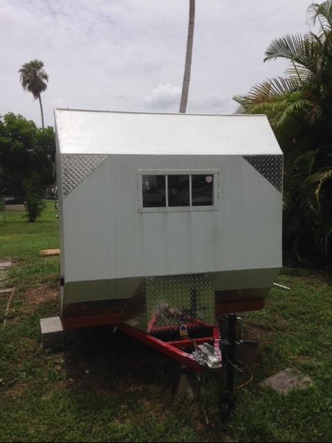

I angled my front in a couple inches on each side of my Weekender-XL- I had tested the 3/8" plywood and determined I could bend it that much without much difficulty. I have no way to determine , if it was worth the extra building effort, but my HHR was showing a steady 20mpg when I towed my build on a 30 mile round trip to the scales and back. I probably added an extra 20 hours of work doing this, but I'm retired, so my time is plentiful.
If you stand in the front corner you can see the couple extra inches of sidewall showing. I was trying to eliminate some of the wind turbulence/drag in the front corners.
Mark
