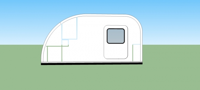

Postby jsparrish26 » Thu Apr 09, 2015 6:20 am
I jumped the gun, and my "profile" with the bulkhead not visible has several transparent spaces in it. Without re-creating the whole thing, is there a way to fix this? Also, sometimes when I draw a new shape or gridline, it shows up under the current item (circle for my rear hatch is under the rectangle, unable to see it unless it is bigger than the rectangle). Thoughts and tips would be appreciated.Image

Postby danlott » Sun Apr 12, 2015 2:14 pm
jsparrish26 wrote:I jumped the gun, and my "profile" with the bulkhead not visible has several transparent spaces in it. Without re-creating the whole thing, is there a way to fix this? Also, sometimes when I draw a new shape or gridline, it shows up under the current item (circle for my rear hatch is under the rectangle, unable to see it unless it is bigger than the rectangle). Thoughts and tips would be appreciated.Image
The transparent spaces you are referring to appear to be areas where the surface was deleted. The best was to get the surface back is to redraw (draw over) one of the existing lines that is connected to the deleted surface. This should recreate the surface. Another way to recreate the surface is to draw a connecting line across the deleted surface for an exiting edge or point to another edge or point on the opposite side of the deleted surface.
