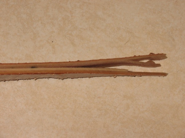

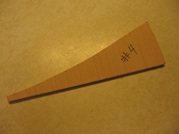

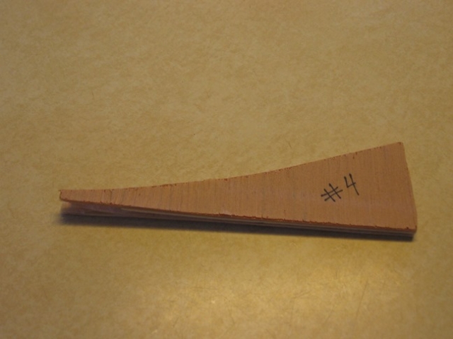

Postby EZ » Thu Mar 07, 2019 12:03 pm
Went and purchased my test sheet of Revolution Plywood from Lowes. $15.88 plus tax for 4 X 8. I was considering using it for exterior skin. It is really kind of weird stuff, seems very hard. Nice and smooth and appears like it would lay flat well. However...
After pouring boiling water over a test scrap and then a couple days submerged in water, it totally failed the waterproof test. Picures below. I am presently soaking a larger piece and expect a similar result.
Before test
After test
Side view
I am sad. I wanted it to work. Encapsulating it in epoxy might be good enough to allow its use, and I will test that as well, but I am probably not going to risk using it. Ho hum! :thumbdown:
