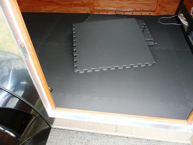

What do you think about using those foam snap-togther exercise mats as an internal flooring to keep the chill off? Plus spills can be wiped clean on this surface compared to a rug or carpet.

Postby mikeschn » Mon Nov 25, 2013 6:05 pm
I use those snap together pad on the floor in the basement. Very comfortable on the feet.
They would work well as a way to reduce the convection between the human body and the plywood floor. But in your photo, isn't that what the 4" foam mattress in a teardrop is for?
In a pod, if carpet padding was not available, I think those snap together pads would be good. I think they are like $20 for 4 squares.

Postby aggie79 » Tue Nov 26, 2013 11:59 am
mikeschn wrote:I use those snap together pad on the floor in the basement. Very comfortable on the feet.
Mike,
I owe you an apology. I didn't read your post correctly. You said you used "carpet padding". I didn't pick up the "padding" part. I think that carpet padding is an excellent material - and much less expensive - to reduce the convection.
