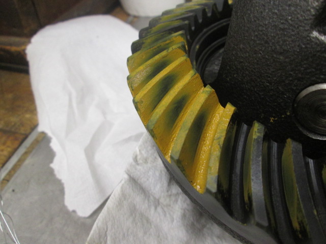

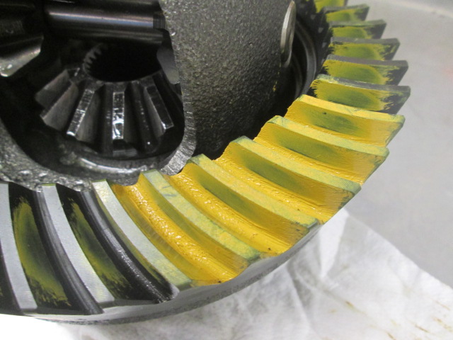

Got the inner pinion and carrier bearings pressed on tonight. Minor snafu, I lost track of which bearing cup went with which carrier cone. Slight subliminal idea, but I give it a 45/55% chance of getting it figured out after the fact. I'm not sure how much it matters. Internet experts say to keep them paired in their original sets, but I know from experience that some Timken bearings come as separates, so I'm not too sure how important it is. More important not to mix used components with new, I think, than to mix all new components. I do have another full set of bearings (because I had both low and high pinion setup kits), but I'm not sure it is worth it to waste these.
Anyway, here are those pictures of the gear mesh pattern. This is the more vertical drive side of the tooth.
And here is the more slanted coast side.

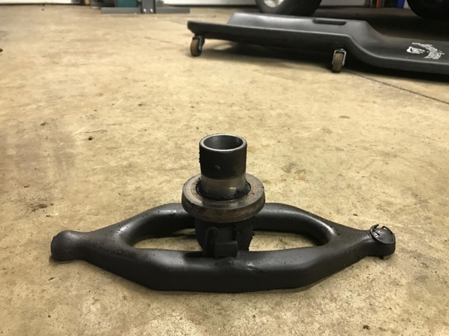

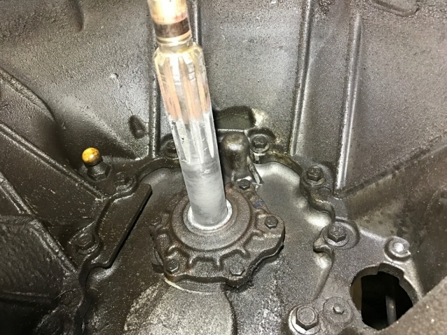

Postby KCStudly » Fri Mar 17, 2017 8:55 am
Jeep NV3550 front bearing retainer snout... busted off. Throw out bearing not working well at all after that.
That tubular thing in the middle of the TOB is supposed to be attached to the bearing retainer where you can see the shinny ring of broken metal.
[urlhttps://www.youtube.com/watch?v=lhzWOti-Yf4]Oops, you broke it.[/url]
