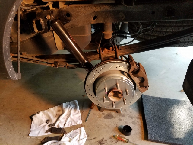

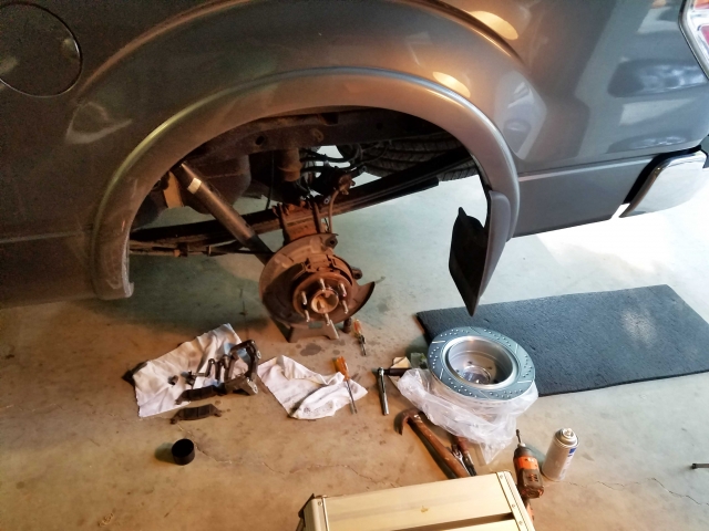

Job is done. 2 1/2 hours to do first rear one...45 minutes for the second. Quite a learning curve.
At 76K miles, shocks were totally shot. Brakes and rotors were good for say another 25K. But went ahead and replaced them anyway.
Rear Before:
Rear After:

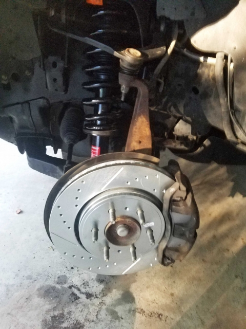

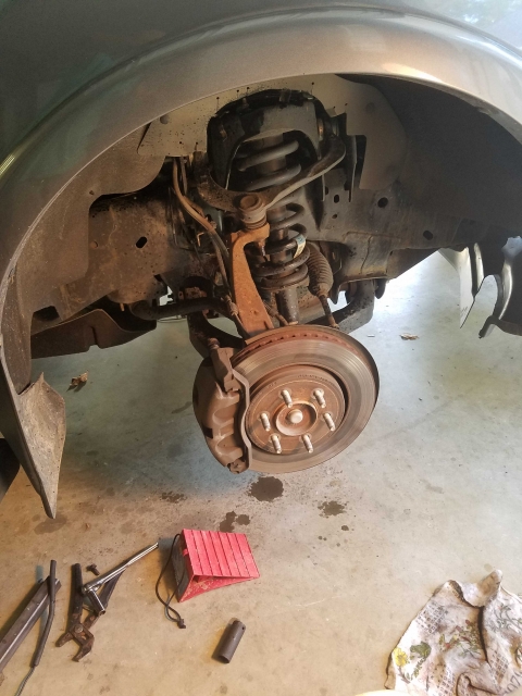

Now the front was different. Had to totally unbolt all ball joints. Had to build a breaker bar to loosen a 350 ft lb bolt. And ball joints were tough to remove. First one took 4 1/2 hrs to complete. Second 2 hrs. Another learning curve.
Brakes and rotors shot, and could not tell on the condition on struts as the spring was still loaded on the shock. Went ahead and replaced struts anyway.
Front Before:
Front after:

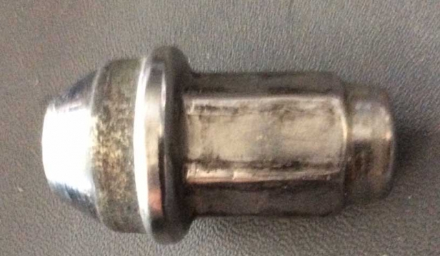

My tire guy told me that the OEM lug nuts had a chrome sleeve and after repeated uses, they would expand and either stick in the socket set or not fit at all. I verified this when I removed and reinstalled them. I have order a new set of solid steel ones which I will give to the garage when I have the tires rotated. And I learned that you have to be careful with what you get as many aftermarket rims require smaller lug nuts. So you have to research which set of rims you have. Do the homework.

2 piece acorn nuts how I despise them. But my uncle saw I had switched lug nuts on my Jeep and gave me a lecture. So I know have a supply of 2 piece nuts. I no longer have my Jeep or my Uncle. But I have this memory to share.
