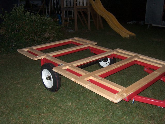

GH good to see progress isn't, Have you thought about setting the axle back...it looks like it may need it or riskk being light on the tongue...if you look at TomS build journal I think he has it documented about how he did it on a similar trailer or you might want to consider buying a set of Kuffel Creek Cubby plans for that info and a lotta other reference/question answering material
madjack 8)
Posts: 15132
Postby Green Hornet » Wed Nov 09, 2005 5:59 pm
I thought about moving it. I believe that with the overhang I am going to have I might be ok. I don't want to do it unless I absolutly have to. As is the door will clear the wheel nicely. If I need more weight up front I may add a storage box on the spare tire carrier, if needed. We will see. Being bolt togeterh I think it can be done after the build also. KISS if ya know what I mean....Nyuck Nyuck Nyuck wise guy! Love yer Larry by the way! I wanna be Shemp if you have any more of those Avitar thingys!

Spent time this morning putting the sub-floor together. Had to rush a bit before I had to get ready for work, so no pics. I will try to get something up next week. It turned out to be quite time consuming cutting lap joints. I had a bright idea to use the router, the only blade I had was too short :x
Wound up using the ole table saw with good results, have a couple more boards to cut. Then glue and screw! :thumbsup:

Postby Green Hornet » Tue Nov 15, 2005 7:11 pm
Got the sub floor done just a lil bit ago and have a pic of where I am at so far. getting too dark to lay the floor down!
Green Hornet
Posts: 176
Joined: Thu Oct 27, 2005 5:27 pm
Location: Port Saint Lucie, Florida
Postby Hardin Valley Magic » Tue Nov 15, 2005 9:44 pm
Good looking base.Are you going to use the factory fenders or build something out of wood? :thinking:

Postby Green Hornet » Wed Nov 16, 2005 6:08 pm
I am going to box them in. I might use fiberglass or epoxy to seal this area well. Thanks for the encouragement! My oldest son and I are having great fun together! :thumbsup:
