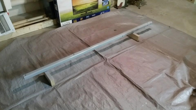

I've been on vacation for the past week so no build progress has been made. However, before I left I gave the drawing for the tongue extension to a local fabrication shop. They called while I was gone and said that it was ready so I stopped over on my lunch break today and picked it up.
Why a tongue extension?
Extending the tongue creates a larger distance between the rear bumper of your tow vehicle and the front of you trailer. This means you can maneuver into a tight camping site easier because you can turn a much tighter radius without worrying about your trailer hitting your bumper. With my last build, I could get my car and teardrop 90 degrees to each other and still have wiggle room. Backing the trailer is also MUCH easier with a longer longer distance between your tow vehicle hitch and the trailer wheels. And finally, it drastically reinforces the tongue and gives you a much better place to mount a wheeled tongue jack. Mounting a tongue jack on one half of the a-frame tongue works, but it puts a lot of torque on the one side of your frame. Is extending/reinforcing the tongue necessary? Nope. But it makes a huge difference!
Cost for steel, including drilling the seven 1/2" holes was $67.58. I don't have a drill press, so this saved me at least an hour worth of work and a $20 drill bit. Totally worth it.
The grouping of 4 holes at the right end is for the coupler. The coupler that came with the NT trailer kit (made for 2-1/2" tongue) gets replaced by a coupler for a 2" tongue. New coupler was $24.99.
The two vertical holes towards the left end are for bolting the extension to the first two frame rails. The hole that is 56-13/16" from the left end is for a bolt to go through the flipped coupler mounting plate (which already has holes through it).
Total cost for tongue extension (including taxes) was $94.33. (This does not include paint or nuts/bolts)

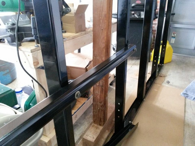

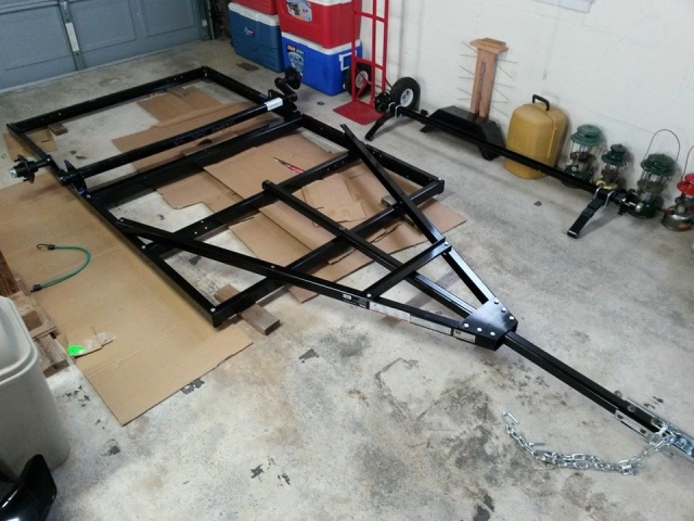

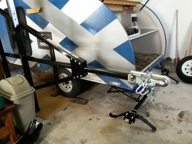

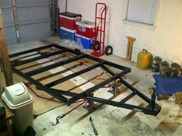

Installed the tongue extension last night. All the bolt holes aligned perfectly! :twisted:
View of the top side of the trailer. Note the location of the short piece of steel that ties the two rails of the a-frame tongue together. I had to move it from the top of the tongue to the bottom of the tongue, or otherwise it would have interfered with the extension. No drilling required.
Bottom view showing where the tongue extension bolts to the first two cross members of the trailer frame.

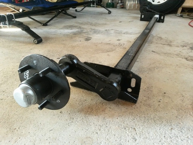

Got a call from Redneck Trailer Supplies this morning letting me know that my axle was in. Decided my retired father would be down for an adventure, so I asked him to go pick it up for me (about 45min away) since I have to work until 5. He got back to town a little bit ago and I went to meet him at my house quick to help unload it into my garage. The grease caps were dented, so Redneck Trailer through in a couple replacements for me to put on.
I'm gone again this weekend, for bachelor party this time, so I won't get to bolt the axle to the frame until at least Sunday afternoon. The sooner I get it bolted up, the sooner I can take it for inspection. Wiring and fenders will have to be rigged on first though.

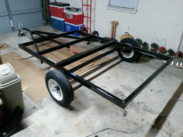

Postby absolutsnwbrdr » Sun Mar 09, 2014 8:29 pm

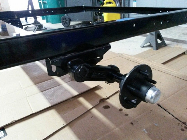

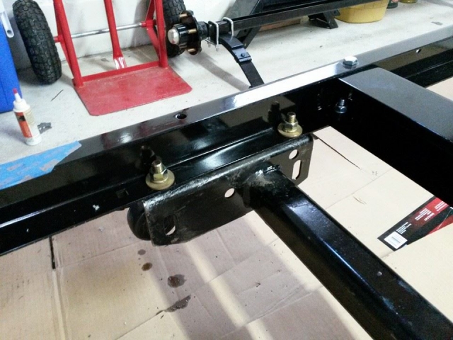

Got a little done on the trailer this afternoon. After wrestling the frame around, I got it positioned upside down so that I could measure out the position for the torsion axle. The center of the hubs is 6" further back than where the stock axle would go. I didn't want to move it too far back because of the added weight of the tongue extension.
After the holes were drilled I flipped the frame and put it up on jack stands so I could slide the torsion axle underneath and into place. I could have bolted the torsion axle into place with the trailer upside down, but then flipping it by myself would have been difficult and I probably would have destroyed the grease caps on the hubs.
Finally I bolted up the 12" wheels which will get replaced with 15" alloys. You'll notice that I'm missing one of the crossmembers towards the rear of the trailer. I'm planning on mounting the spare tire under the galley floor at the back of the trailer, so that one rail needed to be moved forward. The battery for my drill died, so that will get relocated another day. I've marked the new location with blue painters tape.
