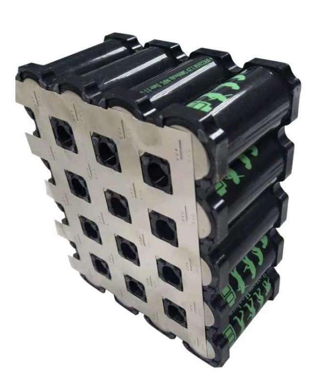

Or I can pick up 100 (or 96) of these 6 Ah cylindrical cells and make a 4s25p 150 Ah (or 4s24p 144 Ah) 12 volt pack, similar to this:
Pros for cylindrical cells:
- more options for battery pack dimensions, making it potentially easier to fit
- don’t need compression
- less impact on the whole battery if one cell fails
- potentially more fun to build
Cons:
- Need to buy nickel strips and a spot welder (extra expense)
- more work and time to build

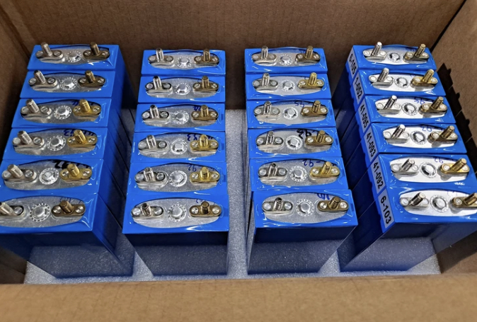

I picked up the batteries today at Battery Hookup!
This will give you an idea of how small they are in comparison to the three Group 24 lead acid batteries I currently run:
Vs.
I checked before leaving, and yes, all 8 cells were in the box.
On the workbench! So excited. Every single one measured exactly 3.28 volts.
I have a work trip tomorrow so I won’t be able to mess around with these for several days. But the bus bars aren’t here yet anyway, so we have to wait!
