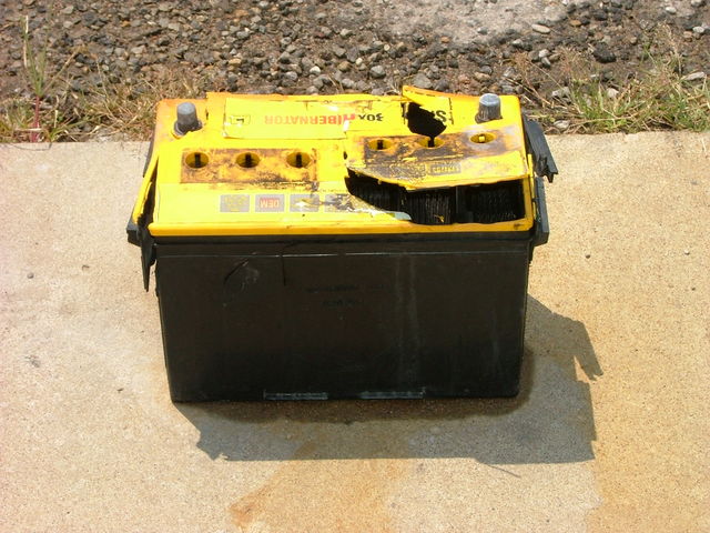

This happened to me at work today:
It was a customer's truck battery. Nobody was around it when it blew, other than me and I was inside the cab. I don't know what the condition of the battery was but it blew like a cherry bomb as soon as I hit the starter!! I know a lot, if not all, use a battery box................ GREAT IDEA!! Keep on top of the condition of your battery.
This was the first time I've ever witnessed, in person, a battery explosion and I hope it is the last. I don't want to discourage anyone from using a 12V system at all because I have one and love it but just want to pass along a "note to self" to keep an eye out for leakage/corrosion/low water, etc.

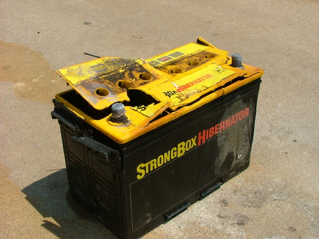

Containers amplify explosions and basically just add shrapnel, you can see the effect on that battery, note that the vent covers have blown away and yet even with that escape route for some of the pressure it as still split the case......
You can several clues as to the neglect that this battery as suffered, note the terminals are partially corroded, this shows that the terminal clamps were not properly afixed and that the terminals were not greased.
Also note the brown mess where the vant cap was, this shows that the battery had been boiling (probably due to a buckled plate between cells 2+3 looking from the worst damaged end)
This was a totally avoidable explosion, with proper care and maintenance this would not have happened.

GeorgeTelford wrote:Containers amplify explosions and basically just add shrapnel.....
I'll have to disagree on this one. I will consider a battery box as a tiny bomb container. It may not hold everything in but will keep the big pieces from flying around. The battery box I have has some big "vents" on the lid for battery cables to go under and a 2" wide strap that wraps all the way around the whole thing. Like I said, it won't hold everything but it's better than nothing. I just wanted to put a bug in everyone's ear about being safe and maintaining their battery. Yes, you are right, this battery was never maintained at all. Most people take care of batteries like they maintain air pressure in tires. They don't worry about it until it doesn't work.

A battery goes off with the force of a stick of dynamite, a flimsy plastic box will not contain that amount of force (far thinner than the battery case and look what happened there!) You can you the vent caps flew off and yet there was still enough force to break the case.
In the above case there was no charging going on (vehicle just being started) and even with the minimal gas that was present, it still had enough force to blow the case apart.
A contained explosion generates a more devastating force.
Sonetpro, Asianflava
You have it the wrong way round...
The optima (and any AGM Battery) only reduces the chances of battery explosion, unfortunately because of its sealed nature if it does explode it is far worse than a normal battery.
I will try to explain this as simply as possible.
In free air an explosion can expand freely, it can dissapate without as much force, the amount of explosive in a grenade would not cause great injury, confine it in a metal case and the force builds up till there os enough to break apart the case, btw having laid the charge from a grenade on the floor and lit it, all it does is flare on a smaller scale consider a hose water runs out, but if you block the hose the force builds up (same principle but bigger scale)
