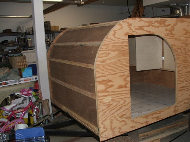

Well I got the glue off, cleared out some so I had a place to put wood putty and now I have a mud yellowish line instead of a gray one. Used Elmers external wood fill.
Can anyone tell me what to use to cover my line so it doesn't show. It was also a little uneven so the fill area is larger in some places than others.
I know I need a sanding sealer but, do I put it on then sand or the other way around?
I've never stained anything in my life so long winded suggestions might help to. :worship:
If the sanding sealer is over the wood fill will it make the wood fill be the same color as the sides?
Thank You so much.

I'm assuming you are going to paint it? Not go for a natural finish? You can use auto body filler (aka: Bondo) to fill and smooth the joint and other flaws... then block sand it with about 150 grit till you can't feel it.
The idea of a sanding sealer is to seal the wood so the wood pores are filled and won't absorb the finish. This makes for a much smoother topcoat. So... best way is to first wipe down the wood with WATER first! This raises the grain and makes little wood fibers stand up. When it's dry, sand it smooth to about 220 grit. Next apply a wood sealer coat. It can be a clear or pigmented sanding sealer. I prefer a shellac based product because it dries fast and just uses denatured alcohol as a solvent. Let it dry good, then sand it again if it feels rough at all. You can apply a few coats to get it nice and slick. The sealer can even be tinted to near the final finish color to help cover flaws (like a joint line). For the smoothest final finish, spraying is prolly the best way... Just like you would spray a car.
If you are doing a clear finish... Well, post again and I'll give you a rundown on ways to do it too.

Postby Podunkfla » Sun Aug 13, 2006 9:27 pm
Thanks for answering. I am only going to paint if I totally mess up this wood. I reallllllllllllllyyyyyyyy love the natural look so I appreciate help.
For a clear finish outdoors use a sealer coat or two same as I mentioned before... and sand off all the nubbies between coats. You can use your topcoat thinned 50% for a sealer just fine. Or, you can still use clear shellac for a sealer (just use non-pigmented, of course), this is faster because it dries quick enough you can prolly apply three coats in a day... Not so with spar varnish... it dries pretty slow.
You want to use the best quality marine spar varnish you can afford. Minwax Helmsman is OK, but is not a great product for long term outdoor exposure. The better marine varnishes prolly cost upwards of $80. a gallon! But, they do last longer & have better UV inhibitors... Ya kinda get what ya pay for with this stuff.
Some folks like to seal their wood with epoxy, like boat builders do... Then topcoat with spar varnish for the UV protection it offers. Costs a bit more, but is a very good way to go too.
Main thing to remember is NOT to use any kind of "Poly" as in polyurithane varnish... None of them will hold up outdoors! :shock:
As for your seam or joint... May be a little late now? But it is prolly best to use epoxy (and fiberglas tape?) to make the joint. You can mix some filler like micro-beads to make a putty to fill voids with too. Of course, one of the reasons a lotta guys put a "woodie" kind of trim on their trailers is you can cover up the joints with trim... I like that look anyway, so that's what I'm gonna do to my tear... 8)

Postby tonyj » Mon Aug 14, 2006 8:16 am
I haven't ever been able to find a wood filler that would hide a cut-line, nail, screw, defect--whatever. None take the stain color or disappear. The ones that say they do--Lie! I think your best avenue is to design a striking trim pattern. Or paint and faux finish a woodgrain pattern. :lol:
If someone does know of a product that "disappears" I want to know, too.
tony
