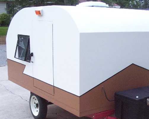

I have finished "encapsulating" with thinned epoxy and painting my camper and it turned out really well. I feel that the $40 and time it took to coat it with epoxy/sanding was well worth it. It is absolutely waterproof with only a little extra work and expense. I also have no trim on my camper edges but the routered corners turned out nice and are hard as well thanks to the epoxy.
I have also read that latex house paint holds up better painted over epoxy than just primered wood (see the link regarding amateur boat building near the top of the thread).
I was trying to go cheap but after using this method on the sailboat I built I am sold on the advantages. I think it is only really considered encapsulating if you coat all surfaces (like the inside and outside of a boat). I think......
Ed
This is a lousey quality picture but the edges are all about 1/4" radius

Your T looks great! I think you're right about the epoxy sealer...I would rather spend a bit more money on sealer than go cheap and have the roof peeling off in the wind...
