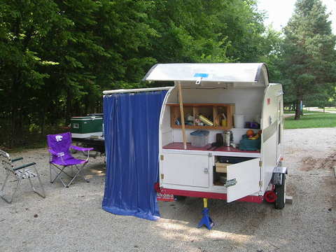

Postby oklahomajewel » Tue Aug 22, 2006 8:11 am
Auntie... I had the same frustrating, intimidation with starting my hatch. I'm finally going to "just do it" and hope for the best! haha
Yes, the Kuffel plans say 1/4" space at top and bottom.
If you look at Tom Walizcek's Rimple , and maybe some others have done it too, he has two doors at the bottom of the galley, then a small hatch for the upper part of the galley. You'd have to look at the pic to see what I mean (I'll look for it ) I wonder if that would help with issues about lifting a heavy hatch, unless you're already planning on gas supports or whatever.
You go girl !!!! :hammer:
Here's his pic:
oklahomajewel
Posts: 3693
Images: 82
Location: McLoud, OK
