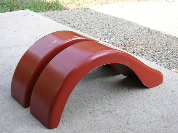

Here are a couple of the wooden plugs that I made to create the molds from.

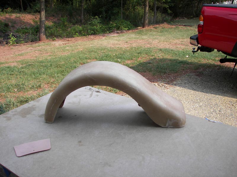

Here is one of the plugs with the fiberglass over them

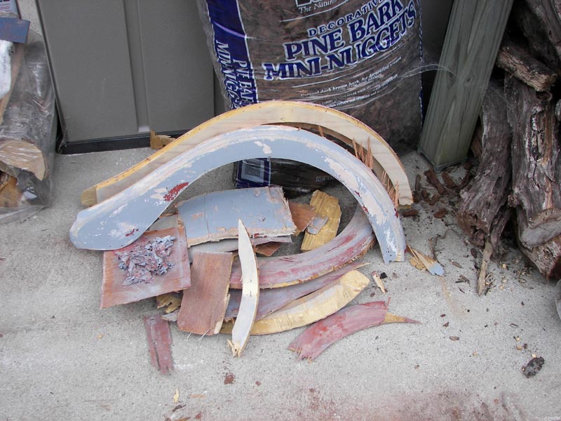

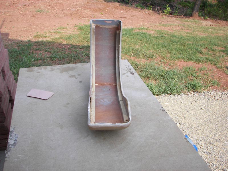

How to get the plugs out??
What's left of the wooden plugs

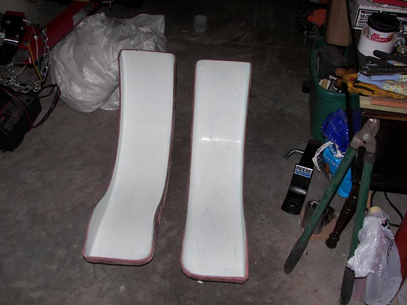

Finished Molds
Now for lots and lots of wax and we can then make some fenders!!

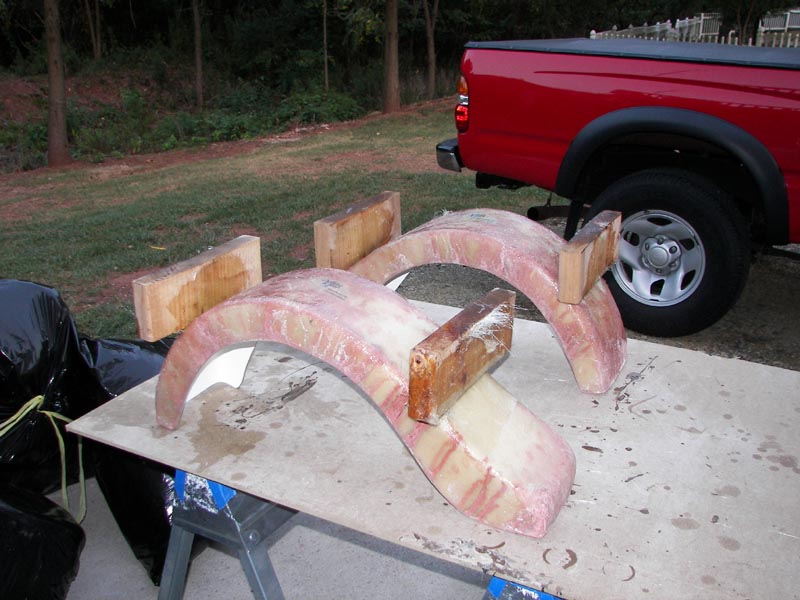

The molds grew ears :) (need them to support the molds when doing fender layup)

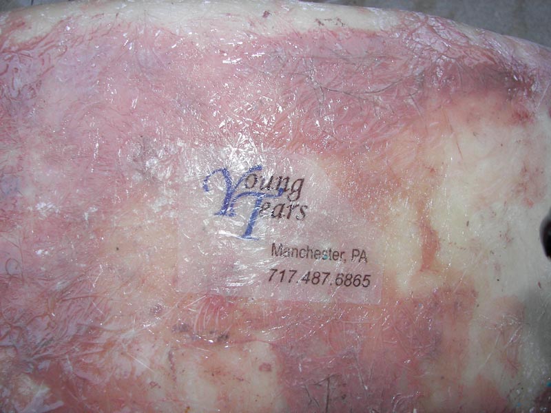

My new logo on the molds

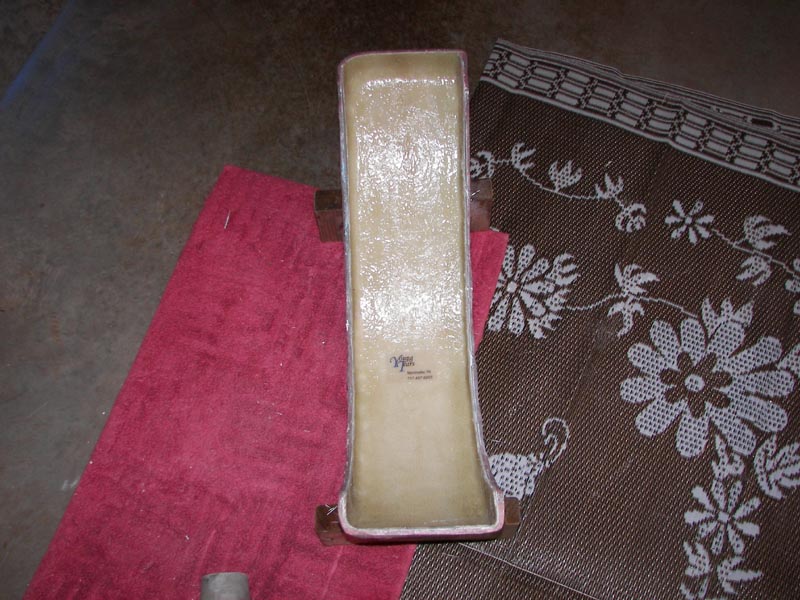

This is the mold with the fender layup curring in it

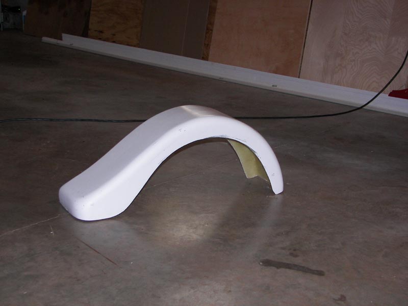

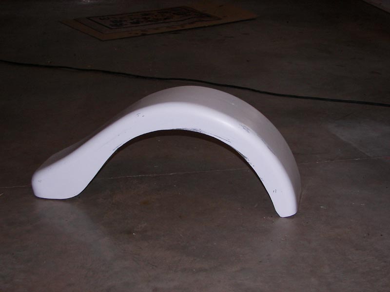

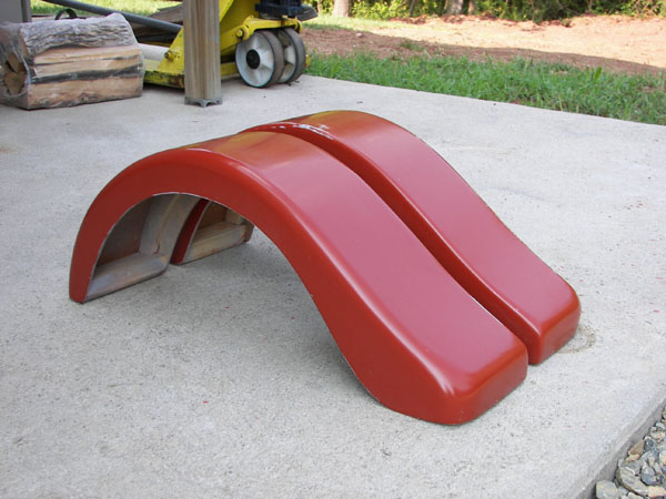

And FINALLY (Drum roll please) is a couple of pics of the actual 1st fender from the molds
They weigh about 5 - 6 pounds per pair and I will get some ideas on shipping cost tomorrow (hopefully). I don't have a final price set yet, but it is looking at right around $150.00 per pair plus shipping. Like I said that is not in stone (or fiberglass) yet, but should be pretty close to the final price. This set is staying with me, but if my work schedule allows me to this week, I will get another, mabe two sets made.

toypusher , they are sweet ! Got to tell you . That is the cleanest shop I ever saw ! Are you going to make them for 15" too ? KD

Those ended up looking really nice. When are you going to hold one up against your teardrop while your wife takes a picture of it?
