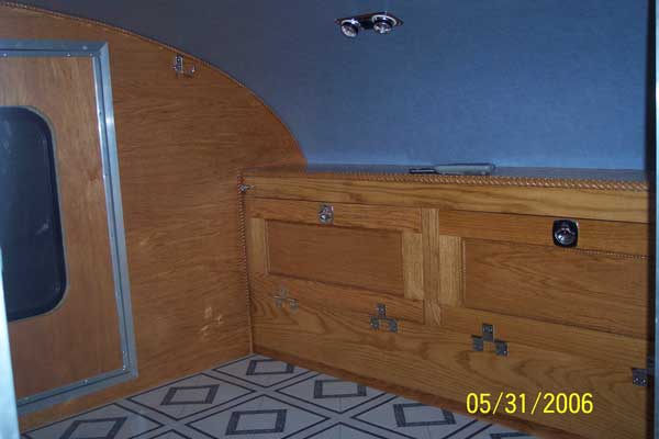

John, I didn' use it for my doors but I used this to edge my 3/4" galley wall's. Lowes has some
Aluminum channel that's made to edge 3/4" ply it's a bit bigger than 3/4" so the ply fit in it snug. They also had 1/2" and 3/8"
It's called aluminum plywood edge.

Postby Loader » Tue Sep 05, 2006 12:38 pm
Steve,
Looking at the photo of your galley; What is the material you used on the interior of the galley hatch? The blue material.

Postby Sonetpro » Tue Sep 05, 2006 1:11 pm
Loader wrote:Steve,
Earl, I got it at lowes also. It's called MDF. It comes it all kinds of colors and pattern's. It's in the kitchen section.
I also used it for my cabin cieling.
