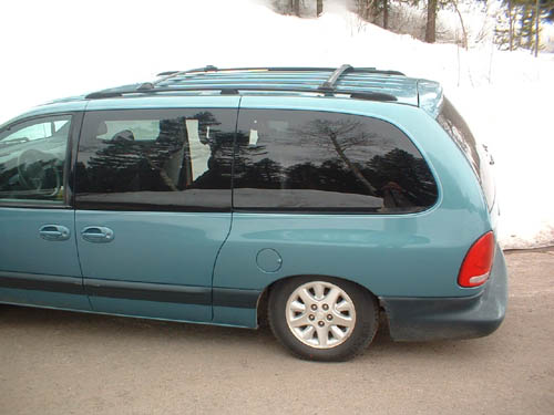

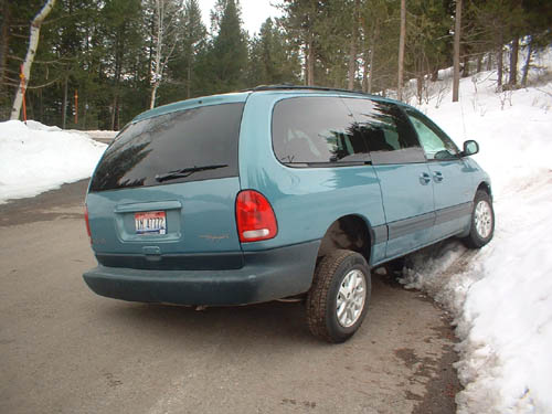

Postby M. Olsen » Mon Sep 11, 2006 1:33 am
And they'll flex too!!
Sunday drive + the boys - Mom + snow = the pictures above. :lol:
