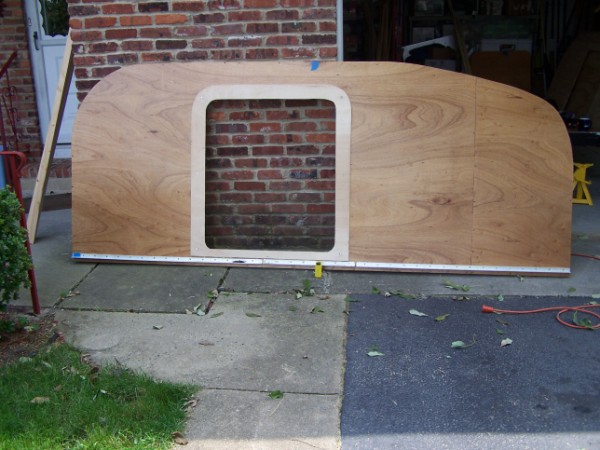

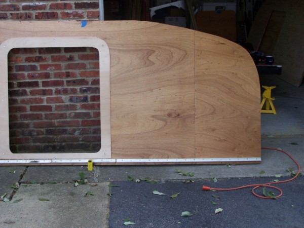

Hi Folks,
Would appreciate judgements about the curve on the hatch end of the walls. The config is part Boxster--front and Boxroy + Better Half's 'I like it' judgement of the curve
Does it look doable in terms of skinning curve etc?
These pictures are a direct result of the endless nagging of Madjack and others and I want to express my ummm....ahhhhhhh sincere appreciation<G> Really! <g>
Thanks, Jim

Hi guy I don't know what the radius of the curve is But we skined a 15" radius last hight w/ a single layer of 5.2 mm luan and it was pretty tough.if it were my tear my main concern would be spring back on the hatch after it is skin but since I have not skinned mine yet lets here what M.j. doug hodder and others have to say but I really like the look of the profile :thumbsup: :thumbsup:

It looks doable. Looks like if mine were turned upside down it would fit yours.

I think you need to smooth out that back radius or you may get gaps before and after it. Wood does what it wants to do so you best bet is smooth lines. This is the foundation of your profile, I would stand back 10' and give it a good look :D Danny

Jim, it's about time ;) :applause: :thumbsup: You will have problems with bending 1/4 ply with out a lotta hot water/steam...using one or the other of those will help tremendously with 1/8th as well...RE what Danny said...take a long straight edge and "roll" it around the edge of the hatch area...if you see any gaps under the straignt edge, it would help to sand these smooth...this sanding if need should be done with both sides clamped together, so they stay exactly the same...I would build the hatch using vertical ribs at least 2 r 3 inches wide and use at least 4 or better 5...this will help eliminate the dreaded "spring back" problem

Jim, you could take a thin piece of flat molding (3/16" x 1" x 40") and make an arc by your back radius ( don't use a dowel) touching your roof line on one end and hatch line on the other end. Have someone draw a line along the edge of the molding. Trim to the line and you would have a smoother radius to alleviate any problems. Danny

Yes Madjack, smoothing it somewhat like your red line would be more appealing. In the woodturning association I belong to they talk about smooth transitions in shapes. Look at the shapes in nature and antique items. They make an appealing transition from one line to another. The human eye picks up on natural looking shapes and draws that person to that object. I’ve seen on this board some who layout their profile with a garden hose & they have the right idea. There are many opinions out there I'm sure, but if your trying to make that retro teardrop shape you need smooth lines. :) Danny

I like the red line profile, see what it looks like if you begin the transition curve at the back of the first curve...it would take out that last flat spot...just 1 flowing curve from the back of the roof down...there'd be no problem getting ply to bend to that...Doug

Ok, thanks for your advice and I WILL look at smoothing out the hatch lines. I did 'experimentally' bend a 1/8" Luan around the bend and it DID go, but boy the tension was tight! The interesting thing is that the profile, except for the 2 feet I added in the middle is almost exactly that of the Tiny Tears pattern...very minor modifications...
