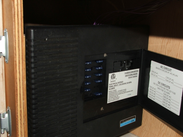

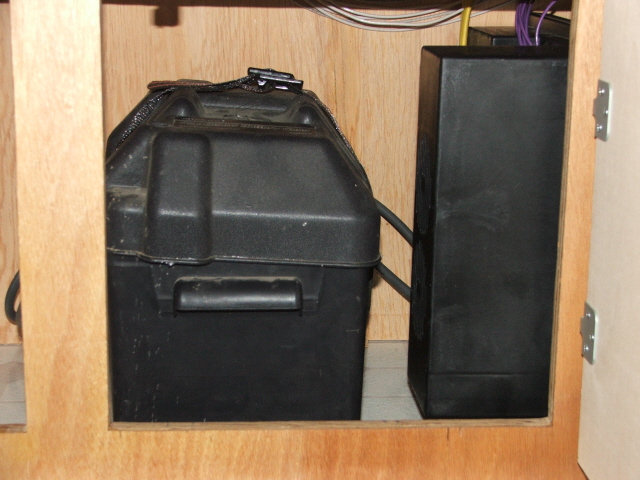

I think you would want a converter. I have a Centurion 3000. When I hook to 120 vac (shore power) the converter runs my 12 vdc, charges my battery, has a fuse block for all my 12 vdc circuits and provides a breaker panel for my 120 vac outlets. Is this what you're looking for?
http://tnttt.com/album_ ... c_id=10987
http://tnttt.com/album_ ... c_id=10989
http://tnttt.com/album_ ... c_id=10988
