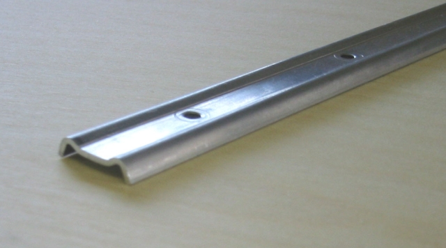

I need help finding a sealant for aluminum seams. On our exterior we've pieced our aluminum, caulked the edges behind, and riveted it to the sides of the trailer. We're wanting to seal the seams before we prime and paint. Any recommendations?

MH, I am trying to figure exactly what you are wanting to do...if you used a good quality sealer/caulk under the edges and then riveted it down, they should already be sealed...did you overlap the AL(correct way) or just butt it up...a little more detail please

we used silicone behind the aluminum sheets and overlapped the sheets approx. 2 inches. Wanted to seal around the outside edges before we painted just extra precaution against waterleaks.

MH, there is flat trim, available from TD parts suppliers, Rv parts outlets and possibly hardware and box stores. the picture is from SoCal Teardrops site

googling...I came across 3M Flexiclear body seam sealant. Looks like this may work. We've got our pieces "quilted" so to speak so I don't know if the trim would work to our advantage. We're just going to paint it camoflage anyways so that will hide any defects haha. Thanks for the suggestion.
