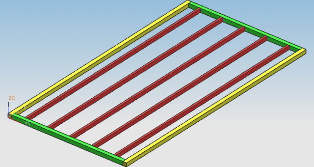

Postby mikeschn » Fri Oct 06, 2006 7:38 pm
This is how I would do the design you have... the red ones are the 1x2s. Notice how I have them inbetween the green end studs?
So why didn't you use the scheme I have setup in the Generic Benroy plans? Just wondered...

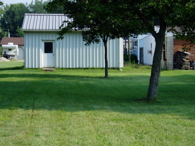

Postby George Kraus » Sat Oct 07, 2006 7:33 am
John
My 24' X 24' home shop is made of door panels. They are the older ones that are 2" thick, they changed to the thinner ones about 8 or 9 years ago.
The seams are watertight only in the upright horizontal position, otherwise use a lot of caulk in the seam.
Started on the long road to happiness

Postby slipperyd12 » Sat Oct 07, 2006 8:55 pm
Mike
The red 1x2 you are showing in your drawing on my trailer are 1x2 ribs built molded into the panel. Each end sits on a 2x2 steel frame. If I cut this back to frame the end all the way across then the ribs will fall short of the 2x2 steel frame rest only on 3/4 foam. I have it exactly as you have drawn it but the ends of the ribs being cut would weaken the ends of the panel.
Thanks John
