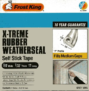

Julie I picked this up at the local hardware store. It works great.
I attached it to the T molding.
Brad (aka Endo)
ImageImage Image

Thanks all...... I'm wondering if I just need a smaller diameter / size of the D molding. I'll look around. I haven't seen the Frost King brand in my local stores.

Endo posted a pic for a "medium gap"...and that extreme weatherstripping is great stuff. I found it for sized for "small gaps" too. Same brand.
Lowes carries a much better selection of weatherstripping vs Home Depot. At least here in Cleveland.
