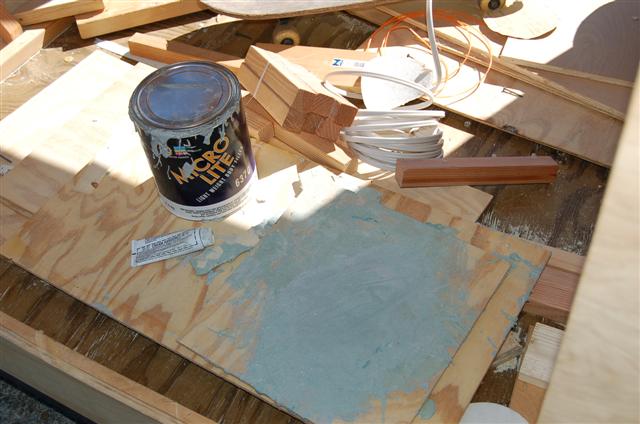

One quick question. What is a good exterior wood filler I need to fill some seams. I plan to paint so looks arn't real important, just to be abble to sand it smooth. Thanks for any help Scott

i used this it worked good for meImage

Postby Jst83 » Tue Oct 17, 2006 8:34 pm
Hey Jude,( :thinking: sounds like a song ) Yeah I'm sure you get sick of that sorry. Micro lite never heard of it. Where did you get it and can you tell me a little about it even after I made probably the oldest joke in the book.

Postby CHUCKLEHEAD69 » Tue Oct 17, 2006 8:40 pm
its basically lite weight bondo it tends to stay a little better than regular stuff not as heavy a friend gave me about a half gallon, Ill ask him who makes it and where to get it (i think napa auto parts but not 100% sure ill find out tomorrow)

Postby Jst83 » Tue Oct 17, 2006 8:44 pm
Thank You, was there any mixing involved

Postby CHUCKLEHEAD69 » Tue Oct 17, 2006 8:46 pm
yes it has a hardener you have to mix in
