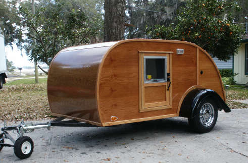

How much travel can I expect on a Flexiride swing arm when hitting a bump during my travels, better yet... How much tire travel should I allow for on my fender, when traveling bumpy roads.
Reason for the question is fender clearance.
There use to be a great shot of one of Cary's Camp-Inn trailers on a big spinning spit, used during their varnish application and it showed the notch they use on their skirt and the notch would give me a good idea of how much travel they allow for on the swing arm, but I just can't find the pic.
My fenders will be hard mounted to my sidewall and I don't want the tire coming up and smacking the fender when I hit a bump.

Postby Dean in Eureka, CA » Fri Nov 03, 2006 2:50 pm
Thanks ALL!!!
My earlier version of the art deco fender was 18" tall and gave me about 4" clearance. A modification to the fender, using bigger quarter elipses on the art deco part made the fender 3" taller... I liked the way it made the top edge of the fender tie in with the Indian accent stripe, but it sorta made the fender look too big. I didn't like lowering the accent stripe to the level of the original fender, because that's where my color transistion is on the dyed ply sides.... Thus, I'll leave the transistion line and accent stripe alone and revert back to the original fender.
