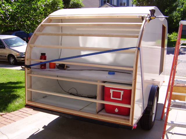

I used horizontal spars and placed them about 6" apart on the curved front.
Sheeted it with 5.2mm Water Resistant Luan and Filon. I never saw bumps or flatspots from the spars. I even did my hatch this way, with only the outside two ribs curved.

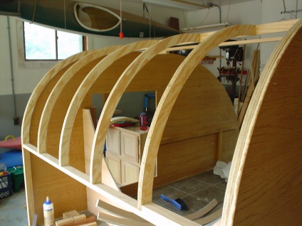

Postby Miriam C. » Sun Nov 12, 2006 9:26 pm
Here is a picture you may like to check out. This is B. Bodemers (Barb.) radius at the top of her tear.
If you do it this way, and use plywood you might want to consider how and where you will put screws. All exposed edges will be the endgrain.
Postby Hudsonite » Thu Nov 16, 2006 6:23 am
That's a great picture! Thanks. It helps out a lot.
