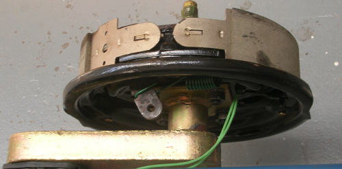

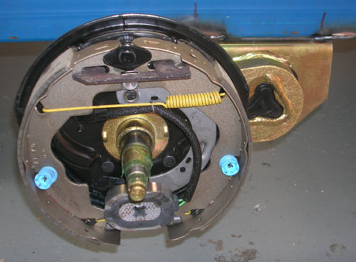

I've got a #3500 Flexride on the new frame, with electric brakes. I figured out that there is a left and right brake assembly. Which way is up? Coil on the bottom or top?
It's painted, ready for the hubs..I'm confused!
Blessings, Steve

Postby halfdome, Danny » Mon Dec 04, 2006 9:41 pm
On my Dexter electric brakes the magnet is on the bottom. I did a searchand found that is typical. :) Danny

Postby Steve Frederick » Mon Dec 04, 2006 9:44 pm
halfdome, Danny wrote:On my Dexter electric brakes the magnet is on the bottom. I did a searchand found that is typical. :) Danny
Thanks Danny!
The brake assemblies are marked left/right. I had no clue which was the top.

Postby Nitetimes » Mon Dec 04, 2006 10:43 pm
The magnet should be on the bottom and pull towards the rear. The magnet arm will be in front.

Postby Dale M. » Mon Dec 04, 2006 11:14 pm
Nitetimes wrote:The magnet should be on the bottom and pull towards the rear. The magnet arm will be in front.
Quite true... BUT...
IF you have correct brake on each side, position is not absolute... IT will function no matter where magnet is located...

Postby Nitetimes » Mon Dec 04, 2006 11:22 pm
Dale
Not quite sure I understand that. If you have them on the right side they should look as I described, that pretty much makes that the position they should be in. :thinking:
They will work in any position, but, they will work their best in their proper position. :thumbsup:

Postby Dale M. » Tue Dec 05, 2006 11:24 am
I think that is what I just said.... In different words....
Dale

Postby Niall » Tue Dec 05, 2006 8:09 pm
I'm yet to see the magnets mounted anyother way but at the bottom, and in any case the hand brake lever needs to be at the top to prevent it being ripped off and/or jammed on !
Mine had to be right , my trailer is built like a helli pad ! ;)

Postby Cary Winch » Wed Dec 06, 2006 4:28 pm
Rick is right, we do offer them. Mainly because of people in other countries wanting teardops but requiring the hand brake. Like Andrew said though this may get us US folks worked up a bit because I can confirm that hand brake components are somewhat tricky to source in the US. They charge ALOT more for the hub with the lever here than without. Then there is the cabling and park lever, not cheap either. So, maybe we shouldn't have seen that photo.
Oh, yes. The magnet goes down on the hub. Make sure the wire comes out behind the trailing arm not under it. I see them get assembled on the wrong side arm from time to time and that is a quick way to check.
