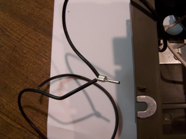

1) a whatzit? question. Here is the picture. The black wire is an extra AC circuit. What I don't get is the metallic thing in the middle of the wire. Looks like an uninsulated wire nut/ connector ???!!!

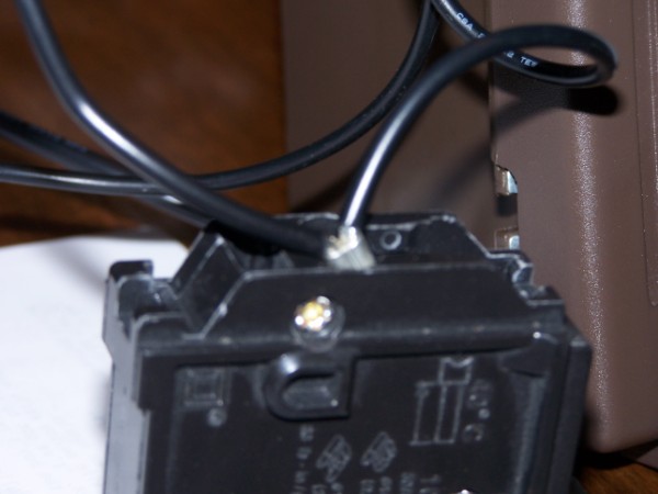

2) The next question has to do with the AC side of the converter that is shown in the next picture:
The open space with the two prongs is the space for the circuit breakers. There are two prongs there, nothing else. I don't have circuit breakers yet, but my question is: how do they mount in that space?
3) For the trailer AC loads--I assume that they are wired directly to the breakers. I will have two AC circuits. One will be a hardwired Air Conditioner and the second will be two AC receptacles wired in parallel--the first receptacle will be GFCI
I assume a two pole AC breaker has a hot and neutral pole and that the ground wire for the load circuit would go on the ground wire bar at the top of the picture of the converter. Is that correct?

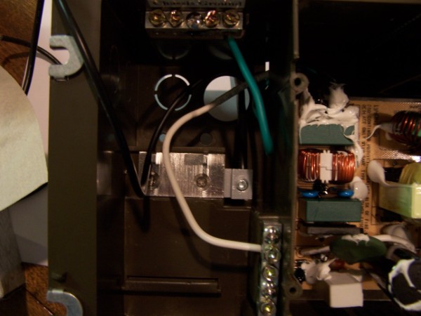

4) My next question is about the DC side of the converter--a picture follows.
The converter has only DC power wires coming out of the back, with no visible means to connect the white return wires from the load to anything on the converter--so, where do the DC return wires from the loads return to? Eg. To what are they attached?

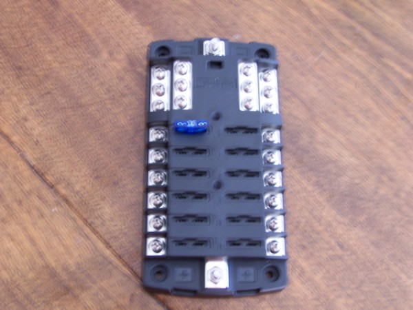

One of my DC circuits from the converter will be to the following subpanel:

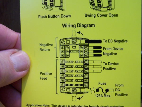

The wiring diagram is as follows:
I assume the DC power cable from the converter will attach to the top terminal on the subpanel--which is the common negative pole. But the mystery is that there is no positive cable from the DC side of the converter--so where would the positive come from--the battery???
1. Yes the wire is for a AC circuit. The pin goes in the end of the breaker this will power both that circuit plus it is the ac feed to the converter.
2. The breaker does not have a hot and neutral.
To mount th breaker the lip on the back slides into the raised lip on the panel. and the prong goes into the slot at the top of the breaker.
The hot goes to the screw at the bottom of the breaker. The ground goes to the top ground bar. The neutral goes to the neutral bar on the right.
The DC wires go to the DC loads. The white return bar is not for the DC it is the AC neutral.
All DC returns go to the battery and not the panel.
The DC power cable is hot. It goes to the bottom where the fuses are.
The battery ground goes to the top.

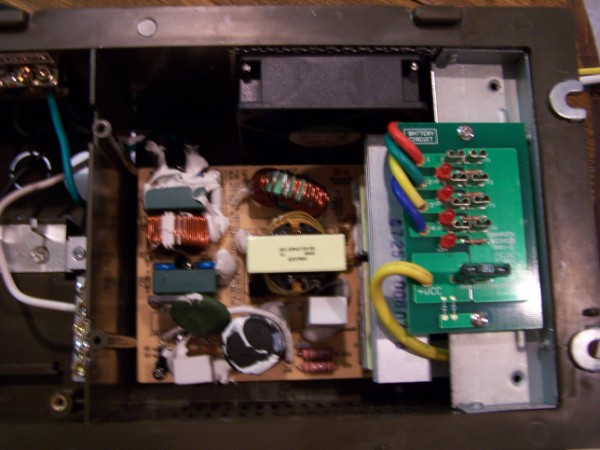

I have the same WFCO converter that you have. Steve T advice is very good “but” please let me add a little more…
The big White wire out of the back of the converter is the DC ground. This has to be connected to the NEG of the battery.
The red wire is for charging the battery. It is connected to the POS of the battery. Please note that the WFCO converter mist have Automotive type blade fuses installed in it, just like the DC panel that you have. (The fuses plug in next to the red LED”s)
The Red, Green, and Yellow wires are extra circuits. DC positive feeds leaving the converter. The big White wire is the common return ( Neg ) for all of them.
I hope that this helps, Dan

Postby Sonetpro » Thu Dec 28, 2006 5:13 am
Jim
This is how mine is wired.

Your pics and advice really are clearing up the fog....let me clarify my earlier post....mistakes I was making.
My first mistake was believing that the battery negative would run through the converter to the loads....hence my confusion about where the negative load wires would run....looking at things as they were in the user's manual and Steve's earlier diagram of the AC wiring, I guessed that the load negatives would connect to the battery negative...Steve's diagram on this thread clarifed that one for me, thank goodness.
But that raises a question in terms of equipment. The white ground wire from the converter goes to the battery negative. in addition, there could be two loads running off the converter DC circuits that need to be connected to the battery negative and finally there is a connection to the fuse subpanel from the battery negative. Is there a harness that lets you hook up that many leads to the negative pole?
Dan's point about the white wire being the common DC ground for all the converter DC circuits got me half-way home <g>

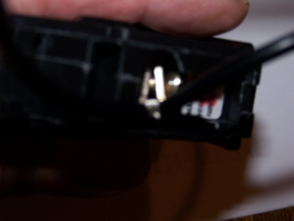

Is this safe, is this right?
Postby kayakrguy » Sun Dec 31, 2006 7:02 pm
Went to Home Despot, got breakers--Squared D's, 20 amp, single pole (with my luck and two breakers, I'd put two two poles in and have the T wired for 220--boy, would that be interesting!!!) :lol: :o
Anyhow, back to my Square D's (sounds like a damn cattle ranch?) Ahem....
In an earlier note on this thread Steve showed how the breaker would be wired and mounted into the converter. So, with that in mind, I brought the Square D's home.
What I expected, based on what Steve had written, is that on the bottom of the breker I would find a recessed hole with a spring clamp inside to accept the pin on the converter's second AC wire What I got instead was a screw down clamp--see pic below....I have inserted the pin….
[img]
http://tnttt.com/album_ ... c_id=16705[/img]
Now, my problem with this is that an awful lot of the pin simply sticks out of the breaker--see the side view below….
Is that really the way this is supposed to go? Is this safe? Everything I have ever learned about electricity (admittedly lacking in the practical side) tells me that an exposed hot pin is simply crazy, hence my questions.
Steve, thanks for the breaker panel explanation, I am putting two breakers in so that solves that <g>
Thanks everyone,
Jim

The wiring diagram (see below) Steve placed here shows the positive wires (blue yellow and green going to the trailer loads, including the green to the positive bus bar on the subpanel fuse box. Now, if I do wire, say, the blue and green directly to loads can I bring the negatives from those loads back to the fuse panel? I ask that because the converter seems to have only a common negative return wire to the battery, no separate bus for DC loads returning from loads
Thanks,
