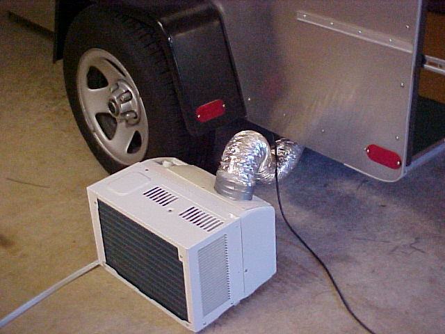

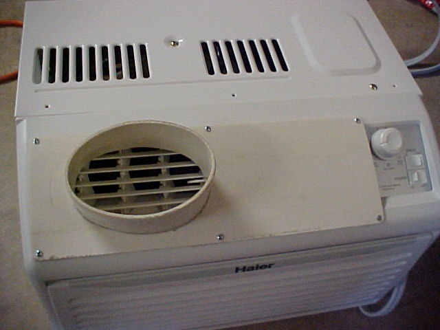

Postby Mary K » Mon Mar 12, 2007 3:08 pm
Julie, I found these pics when I first joined the forum. I do not remember who's it is, but I plan to copy them. Hope this helps.

Postby b.bodemer » Mon Mar 12, 2007 3:14 pm
thanks for those pics MK......................

Postby SteveH » Mon Mar 12, 2007 3:48 pm
Julie,
The pictures Mary has posted are of my airconditioner setup. Just wanted to say it works, but not perfect as the thermostat does not sence the inside temperature of the trailer because there is no return air. I also have to keep a vent open to make it work, which is not really a bad thing. However, waking up at midnight with icycles hanging from you ears is not too good. Have not gone to the trouble yet to fabricate a thermostat to the inside of the trailer.

Postby Mary K » Tue Mar 13, 2007 4:09 pm
SteveH wrote:Julie,
Okay, Great now I Know who I stole the idea from...Thanks! I hope you don't mind I posted your pictures. I saved them long ago when I was researching for my build.
