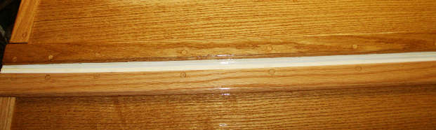

Geron wrote:I'm using this hinge for both hatch and doors
Because it is soft I plan to use aluminum bar on top of it to keep it from dimpling.
But, because it doesn't have a "rain gutter" like the hurricane. I plan to put angle (3/4 x 1/2?) on the cabin side. the vertical leg would be toward the middle of the hinge where it bends. (edited) [on second thought the vertical leg could be positioned either way -- toward the hatch or toward the cabin] This would catch the run off from the cabin and divert it to the sides of the tear. Think that is necessary since the hinge is already "waterproof"?
Also, this hinge should extend past the edge 1/2 inch like the hurricane, right?
Geron

The flat hinge pictured would need something to keep it from puckering when screwed down.

Arne wrote:what distance do you put between the screws so you don't get 'pucker' with a hinge like that...?
