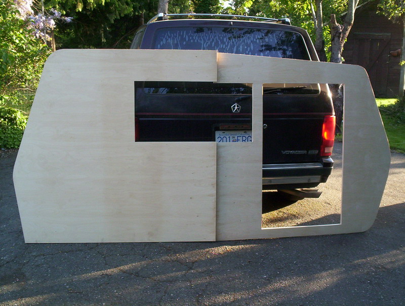

I started my oversized grasshopper build today. Thanks for the help with the profile drawing, Mike :)
I figured The Locust was an appropriate name for a somewhat larger Grasshopper. 8)
Without further ado, here's the first of what I plan to be many pics.

Postby Miriam C. » Tue May 22, 2007 9:43 pm
:thumbsup: :applause: Very nice profile. Looking forward to seeing it together.

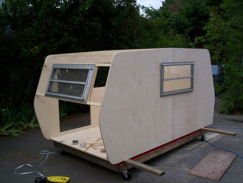

I spent last weekend re-organizing the shop so I didn't get much work done on the Locust, but I think I more than made up for it today.
I now have both of the sides and the floor pieced together, the sidewalls and bulkhead up, and the first of my roof spars done.
Now it looks like this:

Postby Juneaudave » Sun Jul 08, 2007 10:47 pm
Hey Greg...that looks great!!! What's the layout of the interior?? :thumbsup: :thumbsup:

Postby Greg M » Sun Jul 08, 2007 11:10 pm
Juneaudave wrote:Hey Greg...that looks great!!! What's the layout of the interior?? :thumbsup: :thumbsup:
Thanks, Dave.
The interior :thinking: Well, it keeps changing on me :D The latest is an angled cabinet/backrest under the front window with a fold down table on the side wall. There will be a cabinet on the bulkhead with the computer monitor and other electronics as well as storage. If I could just get the design to stand still for a minute, I'd get it nailed down :lol:

Postby steve wolverton » Mon Jul 09, 2007 12:13 am
I like how you smoothed the corners along the sides. Are you going to cover it in aluminum, filon, or paint it?

Postby madjack » Mon Jul 09, 2007 12:30 am
...looks good Greg...but aren't the wheels a little small...lotta RPMs at 70mph :D ;) ................................... 8)

Postby Greg M » Mon Jul 09, 2007 1:56 am
Steve: Epoxy and paint for now. I might go with aluminum in the future, we'll see.
Madjack: Really good bearings 8)

Postby volfanatic72 » Mon Jul 09, 2007 1:50 pm
That really looks good!!! I'm hoping to do something very similar in the near future.
How do you plan on doing the galley area? Is the top part going to open up and the bottom part going to have doors, or is the whole thing going to lift up (if that makes any sense)?

Postby Greg M » Mon Jul 09, 2007 7:09 pm
I'm going to have the whole back end lift. I thought about doing it like the original Grasshopper, but I think this way will give me more freedom for pullouts and the like.

Postby angib » Tue Jul 10, 2007 6:33 am
Greg M wrote:Epoxy and paint for now. I might go with aluminum in the future, we'll see.
What are you going to put around those tight radiuses at the top and bottom? They look too tight for even 1/8" to go around, unless it's 'bendy' ply.

Postby Greg M » Wed Jul 11, 2007 11:45 pm
angib wrote:What are you going to put around those tight radiuses at the top and bottom? They look too tight for even 1/8" to go around, unless it's 'bendy' ply.
Andrew
I'm going the bendy ply route at just those three radii. The rest of it will be 1/8" birch ply. I figure that I'll only need one sheet of the bendy stuff if I get the type that bends around the long axis, and rip it into sixteen inch strips. I'll make the joins on 2x2 spars so that I can epoxy the joins. The only question is: Should I reinforce the seems with fibreglass tape?
