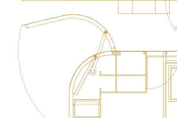

zukamini wrote:I think the farther out on the hatch & higher up and towards front of trailer for the sides, would give you more mechanical advantage. this of course would have to be calculated ,(fully extended strut & fully retracted)without binding. most struts have a slight swivel ball on each end that allows for vertical misalignment ,so a block would not be required for mounting.
