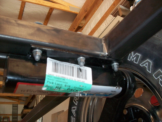

Any chance you can show a close up of the way you mounted the axle halves? I have similar units and I'm still pondering the approach.

Postby David S » Wed Aug 12, 2009 1:08 pm
Burke, here is close up of axel moutning.Probally more steel than needed
I looked for the right size peice so I could u bolt to it but couldn't find it.
This way gave me a little flexability when doing alinement.but after clamping,drilling the holes and bolting it was only off 1/32" when pulling a tape from center od axle up to center of the coupler.I also thoght of laying a short pc along the full pc and 45 a brace across for support but after adding it up it would have taken more steel.I'm impressed with how ridged this frame is,picking up one corner lifts the whole trailer with no flex.Image

Postby 2bits » Wed Aug 12, 2009 5:19 pm
It it good seeing a set of "Stubbies installed". I friggin lost sleep debating whether to do those or a full axle. :lol:

Postby bve » Wed Aug 12, 2009 7:46 pm
Thanks for the axle closeups David, I appreciate it.
