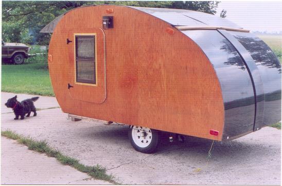

RogHodge wrote: If any one with design skills would like to make a computer animation of this feel free
Looks kinda familiar

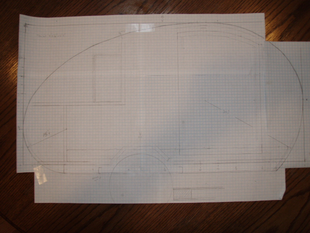

here ya' go RogHodge, this is what I have so far from your drawing - however, i could not see your dimensions to Put it in scale to do a full 3-d rendering and put it on a harbor freight trailer :thinking:

Postby RogHodge » Sat Nov 14, 2009 12:03 am
Okay Pastor- You are my new best friend! :D :applause:
I will provide a better drawing/improve the one I posted already and post it soon- like tomorrow morning. 8)

Postby RogHodge » Sat Nov 14, 2009 1:14 pm
Thanks Dave- Your tear has been an inspiration. I will probably paint in a similar fashion. I hope I can come close to the quality of your build!
I have updated the profile – better sketch. The small squares represent 1â€

Postby starleen2 » Sat Nov 14, 2009 4:18 pm
Made an assumption to complete the scale – I’m assuming that it’s 4 foot wide (if not then I can adjust)
Anyways, here it is to scale

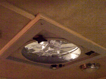

No need to make the roof thicker than you want. You can cut the plastic trim ring on the fan down, and if that's not enough, just add a little wood molding around the fan to give the roof a little more thickness.

Postby RogHodge » Sun Nov 15, 2009 11:28 am
Mr. Stewart- you are my hero- :) Yes it will be 4’ wide, the galley hatch will stop at the counter, small easy(er). I might make an access door on the side in the back – for a battery compartment. I think one door- again easier and weight savings, albeit very little.

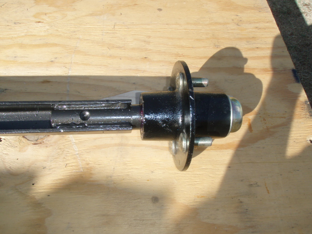

This morning :coffee: I put together a comparison of pre and post axle flip. Here is what you can expect when you swap out 12â€

Postby RogHodge » Tue Nov 17, 2009 7:46 pm
Still working on the frame, hopefully I’ll get a chance to do some work and put up more pictures- Here is the link to the axle inversion- http://tnttt.com/viewtopic.php?t=33550
It was an interesting process- Also I’m going to try to find replacement bearings at NAPA or ??? Seems that HF is out of stock and won’t get them for over a month- grease seals- same thing- hub cap- same thing. :x

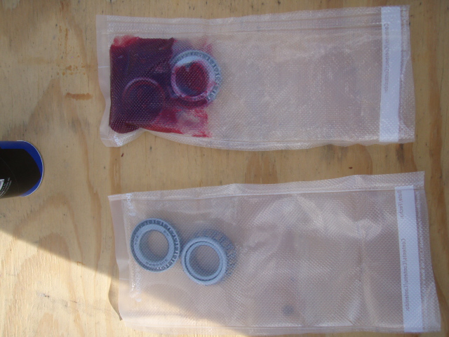

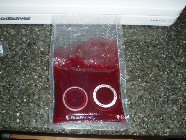

Postby RogHodge » Sun Nov 29, 2009 5:18 pm
Quick update-
I have been pondering how to reassemble the frame- I think I will put some bed frame angle in the sides and bolt it all together. I posted this over in the chassis section but not much in response.
I repacked the bearings and assembled the hubs today- I tried to pack via vacuum pressure. I put the bearings in a ‘foodsaver’ bag and vacuumed the air out and sealed the bag. After it was all said and done I don’t think it was worth the hassle- I ended up hand packing the grease in there anyway just to make sure. It would be a great way to pack extra bearings though. Finally you will see the completed product- in shinny hammered black rustoleum.
BTW- many thanks to Mr. Stewart. He sent me a sketch-up file of my tear- it is really cool to be able to see my completed project in 3D. Thank You!
