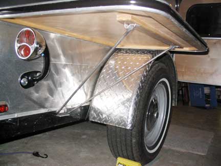

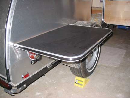

I built one on the side. I borrowed the Coleman Tent trailer idea. With the support on the trailer it requires no special adjustments or leveling. The support is just a length of steel rod that I heated with a propane torch and bent to shape.
http://tnttt.com/album_ ... ic_id=2689
http://tnttt.com/album_ ... ic_id=2690
The table attaches with an extruded aluminum "bracket". I purchased the bracket from TJ's Trailer Supply. The bracket isn't pretty without the table attached, but it's functional.
