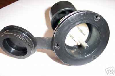

Found this item at Bass Pro Shop. It has a ring gasket on the exterior, positive clamp on the cord end inside. Not cheap at $12+ but as neat and simple as I've seen.

McTeardrops wrote:Found this item at Bass Pro Shop. It has a ring gasket on the exterior, positive clamp on the cord end inside. Not cheap at $12+ but as neat and simple as I've seen.
For $12 That's a good alternative. I've been thinking 30Amp twist-lock, I think I can find one at the boat salvage place. Does anyone use 30A service for their teardrop?

Been looking for one just like that, so I checked at Bass Pro on line and it's now $14.99! :shock:

I have the same one. I picked mine up on eBay (where else.....) for $5.99 plus $3-4 shipping a while back.
Did a quick search and there's one listed there for $10.00 (buy it now price) LINK

Just an FYI, the one you linked on EBAY is a twist-lock.

Hey all- I picked up the Marinco charger inlet as well (rated at 15 amps.) I read somewhere else that if the campground has 20Amp service that you could fry the inlet. How probable is this? Do most CGs use 20 amp service? Should i run out an return this now? Ugh :cry:
