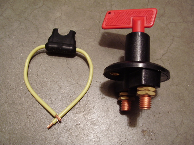

I have a 30 amp fuse and a removable cutoff switch that I got at Checker Auto Parts. I will be able to shut off the 12 volt system and remove the red "Key" that way I know that I didn't leave something on and drain the battery. I will wire the fuse close to the battery then the switch.

The fuse should be as close to the battery terminal as practical. The theory is, that there is less "unprotected" wire.
