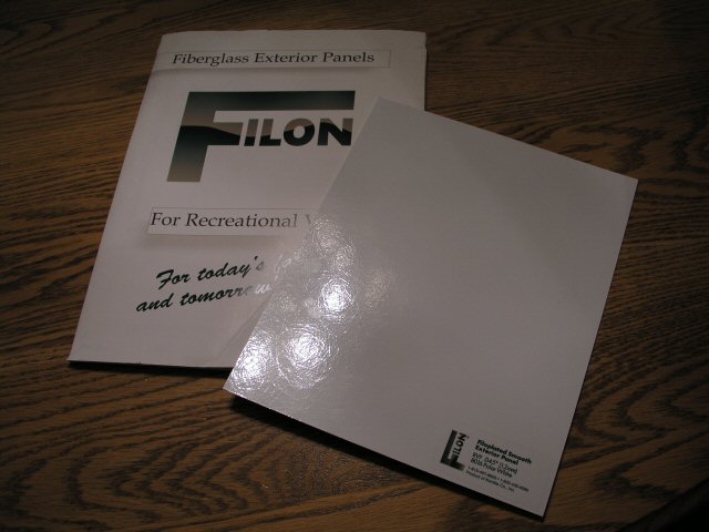

bdosborn wrote:FRP (or Filon) is the stuff that they side motorhomes with. I used it on mine and I realy like the thermal properties. While I was in Minden I felt the top of my trailer and the top of an aluminum skinned trailer next to us. My roof was barely warm and you could fry an egg on the aluminum one. Don't use contact cement to attach it. Mine is delamintating in places on the sides so I have big bubbles that come and go with the outside temp. But, the main reason I used FRP is that it is hail resistant. We all replace our roofs every ten years or so around here.
I took a picture of a filon sample that I have, so that you guys can see the fiberglass strands in it.
