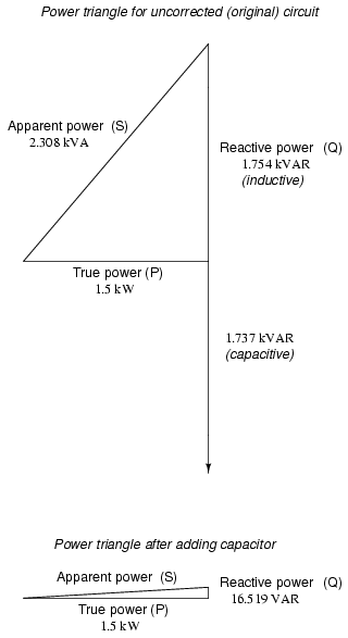

Power factor (the power "that seems" to be required but not actually used) is always a strange one to explain Its the amount of power thats needed to be available for a motor to work, but its not the actual amount power consumed.
Reactive loads such as inductors (motors) and capacitors dissipate zero power, yet they drop the voltage and draw current giving the deceptive impression that they actually do dissipate that amount of power.
This "phantom power" is called reactive power, and it is measured in a unit called Volt-Amps-Reactive (VAR), rather than ACTUAL watts.
Reactive power is symbolised with the letter Q (look at the chart mentioned in the original link) the only column with any obvious difference is the Q column or VAR, Then you have apparent power Symbolised by the letter S this is volts and amps without regard for the Phase angle, but even this isnt the TRUE power, true power is a combination of the two, or a measurement of volts and amps accurate, you do not get billed on VAR, only on the P or watts (true power) column is your billing amount note the difference there....
So although the power company give you 110 Watts because you only borrow the last 10 and give it back you only get billed for 100 Watts.

Back to your original post, the PF correcting unit is a rip off.
1. They picked an especially inefficient motor to sell the their unit.
2. Capacitive correction of PF has to be tuned to the load. Otherwise you get especially nasty power quality problems (resonance) ie. Your washer works great but your computer burned up.
3. George is right, you pay for Kw-Hrs, not amps-hrs. No payback. Ever.
Pure snake oil.

VAR (power factor) is being closely metered in the power industry. In part to help calculate the need for capacitor banks or reactors (induction units) for power factor correction. If you are in the power generating/transmission business VARs are losses and a lot of money is thrown in their direction to minimize them.
Watts + Volts * Amps * Cos(angle)
Vars = Vots * Amps * Sin(angle)
The angle in the formula is the difference in angle between the potential and the current on the same phase.
So the actual purpose of power factor correction by the utilities is to be able to bill and meter every amp possible, and those amps that go to VARs do not show up on the watt hour meter at your house.
