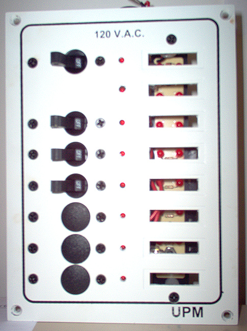

Here's the front. There's a 30-amp main breaker at top, and two 10-amp and one 15-amp lines. The 15 amp will be dedicated for the air conditoning outlet. The 10s will be used for daisy chains on each side of the TD.

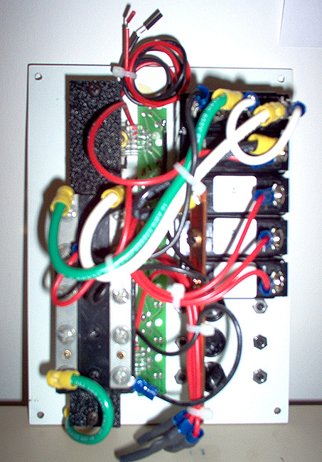

Here's the rear--like I said, a little blurry. Please note the red and black wires coiled up at the top, and the red wires coiled and capped at the bottom.

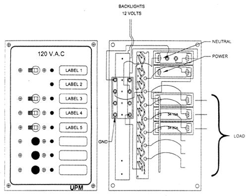

And most important, here's the schematic. (The amperage marked on this is WRONG. The two first breakers are 10-amp, and the bottom one is 15-amp.)
Okay--what the hell do I do NOW?
Let me take this slow and easy...
As you see on the schematic, it seems to indicate those top red and black wires as "Backlights/12 Volts." What does THAT mean? This is a 120 panel.

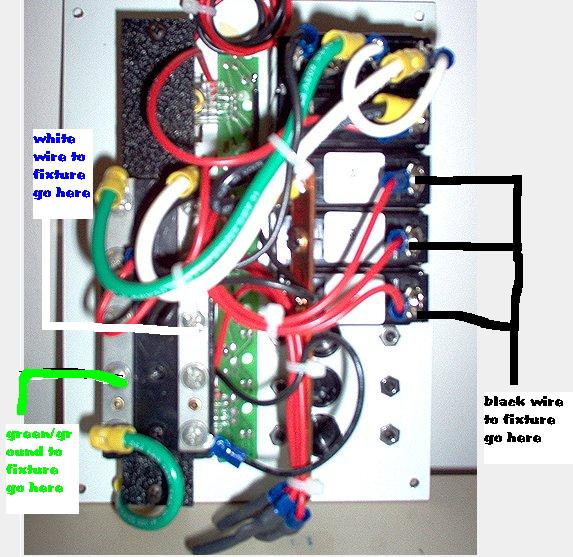

Ira, it is kinda hard to tell from the pic/schematic but the green and white wires on the left(next to each other) are ground(green) and commom(white)...the respective wires from your source go their common buses. On the left, connected to backs of the breakers is a brass/copper colored common bus that is connected to the breakers...this is where the black wire from source goes...it appears that the rest of the red wiring is for LED indicator lights
madjack 8)
p.s. here is a pic for ya

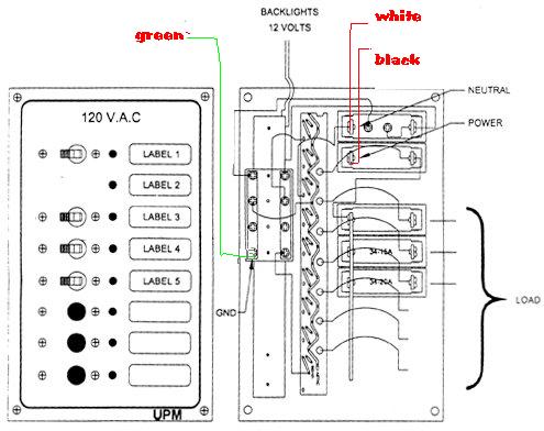

Postby Jiminsav » Thu Dec 29, 2005 11:10 am
the red and black wires at the top..those are 12 volt wires for the panel lights..keep 110 away from there...the red wires at the bottom are for the LEDS that ain't installed..leave um alone
hook the neutral wire from your shore plug to the top breaker..left side..should be a emptt screw there..
hook the hot wire from the shore plug to the breaker right under the neutral breaker..what you have there is whats called neutral switched breaker..when it trips..it disconnects power and neutral..
if'n i were you, i'd remover that small white jumper wire..take the ground wire off the neutral breaker, and wire nut the ground wire from shore plug to it..then, run all your wires to the busses on the left side, and put the hot wires on the screws on the three breakers..you'll be all set

Postby Jiminsav » Thu Dec 29, 2005 12:00 pm
i drew a pic maybe it will help Image

Postby Ira » Thu Dec 29, 2005 12:08 pm
Jiminsav wrote:i drew a pic maybe it will help Image
What do these modifications do?

Postby madjack » Thu Dec 29, 2005 12:21 pm
another pic for ya...
madjack 8)

Postby Jiminsav » Thu Dec 29, 2005 12:36 pm
the mods seperate your ground wires from your netral wires..lets see..the scematic shows a screw sez white..a screw sez black, and green going to the bottom of the grouns bus..so there has to be a terminal on the left side of those top breakers..hook it like it sez..I personally like keeping my ground and netraul seperate, but my house is wired hetral to ground..so i guess it's ok.
oh yeah..like Jack sez..hook the hot wires from your tear circuit to the lugs with the red wires..leave the red wires..they indicate that the circuit is hot in the LED panel..hook all your netrals to the netral bus, and all the grounds to the ground bus..you can wire nut them all together and run one wire to the busses..it makes it easier.
