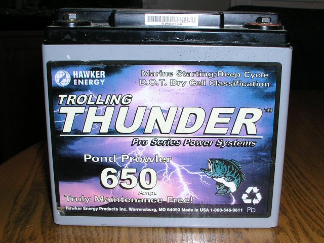

In fact, I have a Hawker Pond Prowler, I guess that would be one of these...
http://www.enersysreservepower.com/ody_ ... ?brandID=5
So what's the better battery to get? And are all battery amps rated the same way? My deep cycle battery on the TAB is an 84 amp battery. Yet my trolling thunder battery, which is the size of a motorcycle battery is rated 650 amps. :?
That's exactly why I'm confused! Is an amp an amp, and what should we be using :? I know of/heard of Hawker products, in fact they have been used in aviation applications.

...the 84A is amp hours, the 650A is cold crank amps...don't ask me the representational deference 'cause I sure as heck don't know...
