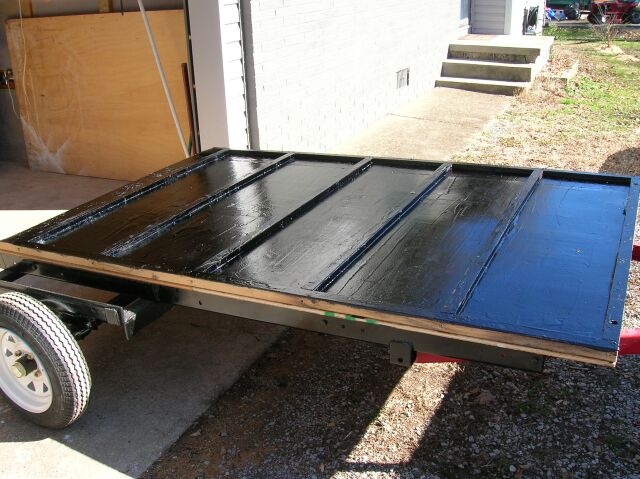

Postby mikeschn » Mon Feb 13, 2006 6:19 pm
This is what I used...
