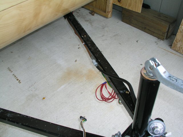

I use soft copper tubing with flare fittings...
Let me see if I can find a picture...
P.S. Okay, here's a picture of the tongue. You can see the pressure regulator that goes on the bottle. On the other end is just a flare fitting.

Postby JIML1943 » Mon Feb 20, 2006 3:56 pm
I'm with Mike on the copper tubing,all of my appliances have built in regularors, instead of running high pressure to back of TD i put a 10# regulator on the tank with flex hose and ran copper tube under TD and tee's to appliances.

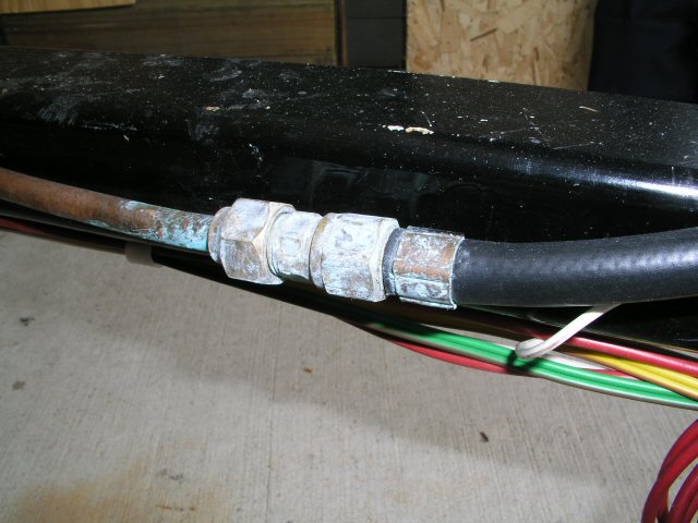

Postby mikeschn » Mon Feb 20, 2006 4:06 pm
Nope, there is no solder. Here's a close up of the flare fitting. It just looks messy from the soapy water that we put on it...

Postby Jiminsav » Mon Feb 20, 2006 8:58 pm
OMG Mike...you didn't wash the soap off and now you have corrosion..need a light?

Postby mikeschn » Mon Feb 20, 2006 8:59 pm
:oops:
